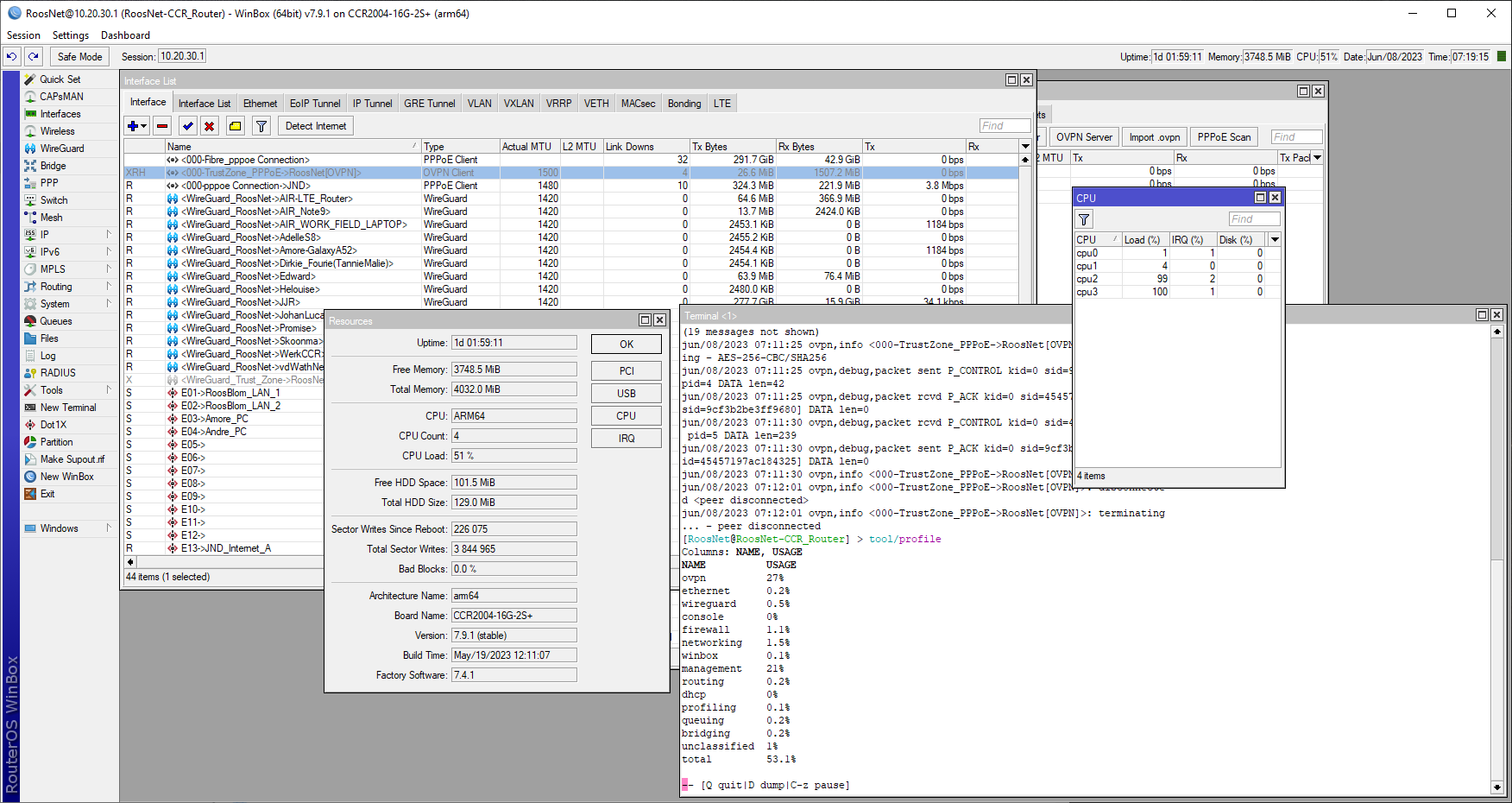

This is what I observe when the issue accures. I cant disable the OVPN interface, it just returns a error message that the time have been exeeded and cant disable the interface.
I moved to wireguard for the TrustZone VPN. This solved all my issues. Still not sure why OVPN gives issues. Maybe a configuration issue on the OVPN interface or another issue entirely.
