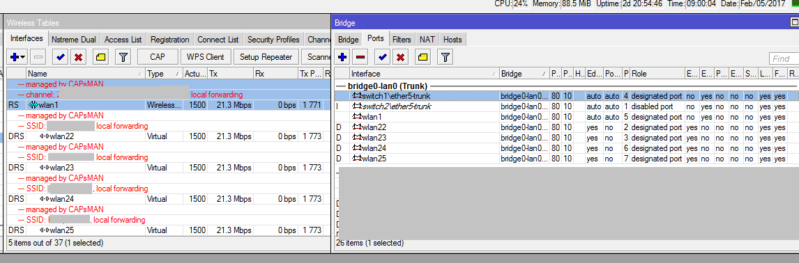

I’m dealing with the same problem. I have a RB2011UiAS-2HnD-IN, but it doesn’t matter, the problem occurs on every RouterBoard I have(RB951G-2HnD, RB750Gr3, RB941-2nD, RB912UAG-5HPnD, and many more). I tested it on every RouterOS since 6.30. I don’t know how to deal with it.
