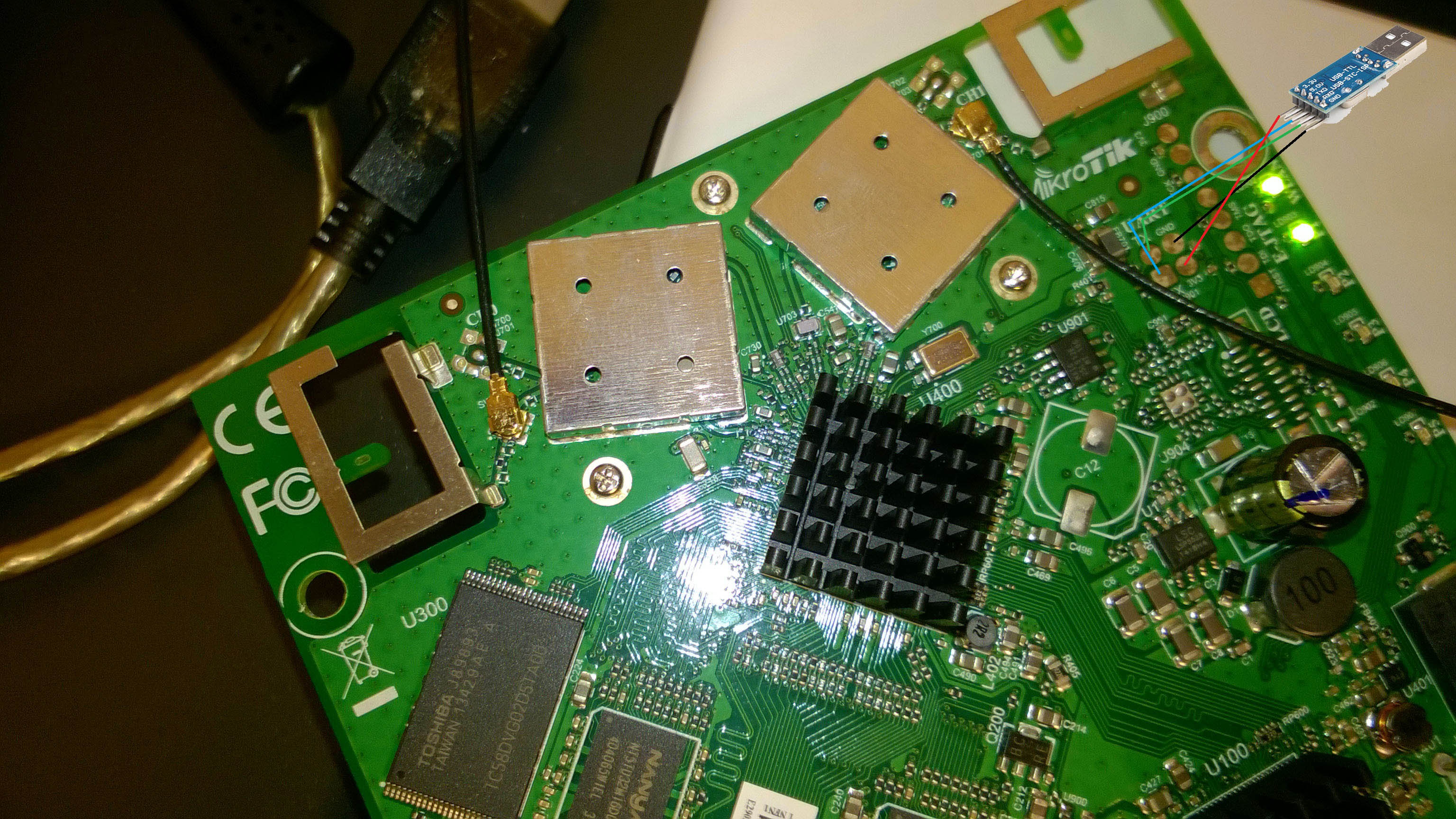

You can enable from serial port
(on board serial header connector with usb to ttl converter with tx and rx pins)

I do have a USB port, but any nice guide to connect it over serial port would really help. I thought it is solely for powering it up (an alternate power source)
@ErfanDL, I am assuming you are referring to this ? https://www.sparkfun.com/products/12977 . I may need a raspberry pi too in that case.
there is no need raspberrypi. just conenct the usb to ttl converter to your PC ! dont forget to install the driver
connect the USB to TTL RX pin to RouterBoard TX pin
connect the USB to TTL TX pin to RouterBoard RX pin
connect the USB to TTL GND pin to RouterBoard GND pin
then turn on routerboard and by putty access the serial with correct COM number ( you can see in windows device manager )
if not work, connect the USB to TTL 3.3v pin to RouterBoard 3.3v pin ( test with and without turning on routerboard )
