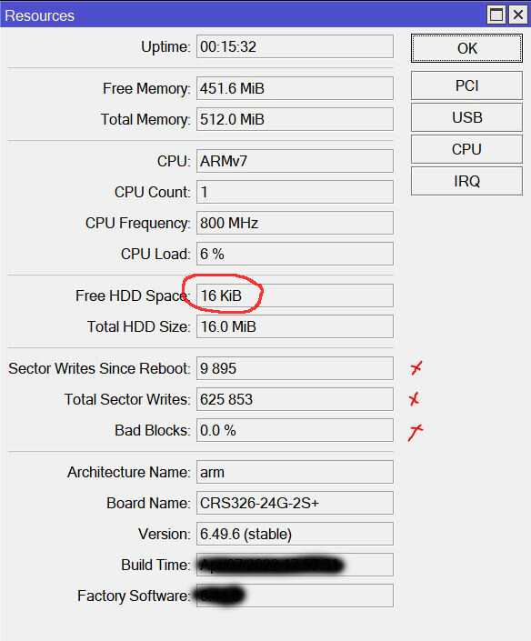

Me too. I’m using CRS326+24+2
There is nothing wrong with the disk, but it is too small. Only 16Mb.
I lost part of firewall configuration and part of static DNS.
It’s seem that that part remains in the memory and lost when I reboot the MK.
Netinstall.
