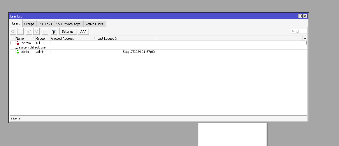

Just tried update to 7.15.3 and I see that my account has no permissions to do anything.
There are no other accounts only me and some System account.
Router is on 7.15.1 , RB1100

It sounds like your device has been attacked/hacked, there are several reports that an user “system” is created with all privileges and admin is limited to only a few ones.
http://forum.mikrotik.com/t/router-possibly-hacked/172357/1
Only way out - I believe - is netinstall and start again from scratch.
You were thrown out of your own router. My condolences.
Make an export if possible, that will help you reconfigure after netinstall.
Unless there is some other trick, I don't think so, If it is the same attack as on the given link the admin user is prevented from opening Terminal.
