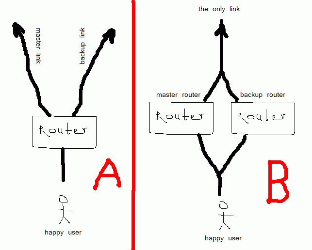

OMG!.. so how many internet connections do you have: one or two?!?
first you said that you have two different links, now you say that you have one link, as Janis wrote…
UPD: please select A) or B)
My bad Chupaka, I do have two (2) internet connections, I didn’t mean to confuse anyone. I misread/misinterpreted Janisk’s reply.
I am confused why everyone seems to believe that VRRP is only for one ISP connection/link and not for two (2). I have even been advised that only one router is required with two (2) ISP connections/links. My question on that is how can you accomplish this with one ISP connection/link, when the IP address (public) will be the same on two separate interfaces on the same device, I don’t believe the device would even allow you to assign the same IP on multiple interfaces.
So, we’re back to square one, two (2) ISP connections. How do I get VRRP to work? That’s VRRP, NOT load balancing.
vrrp again… VRRP is for B)
if you need A), then
but… why same addresses on different interfaces?.. post the details of your config, please

but in case of vrrp, you will switch to another internet channel only if the first router will fail. if first internet channel will fail, but first router will still work - second channel will not bring up
At last, we are on the same page. Now, you have a valid point concerning the ISP link failure issue, as apposed to hardware/router failure. This is the exactly the same as Cisco’s HSRP. However, for now, I’d just like to get VRRP working and then maybe, I could start a new topic on how to obtain a script to possibly disable the VRRP interface on the master router if it’s gateway cannot be reached, so the backup router will assume the master role. I believe the script will address the link failure issue you mentioned.
well, if you still need VRRP - so there’s link to examples in your first post. for link failover, you do not need scripts, you should just use http://forum.mikrotik.com/t/lot-of-holes-in-the-vrrp-examples-please-help/29252/7
if I understand your first question in right way, then you should add persistent IPs for each router and then add third IP to VRRP interface, which will be default gateway for your customer. so you have access to main IPs for configuration and as gateway for link failover scenario, and virtual IP is default gateway for a customer for hardware failover scenario
