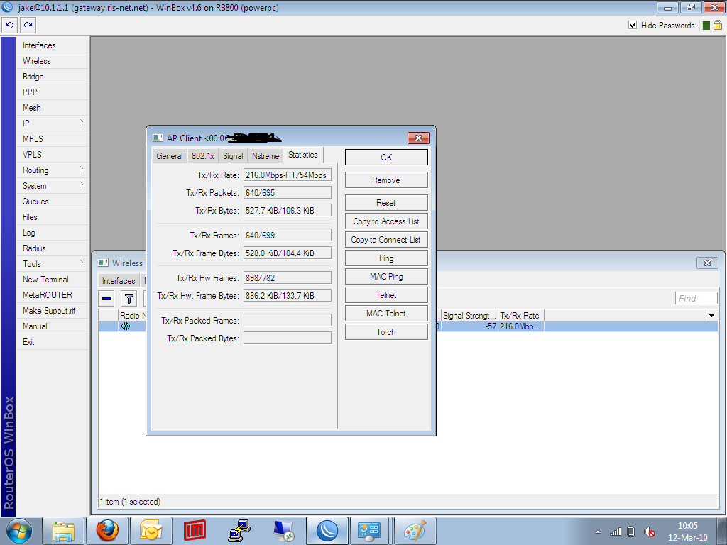

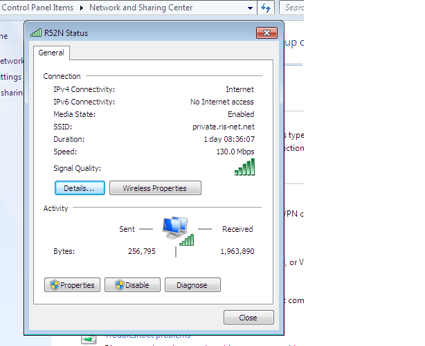

The funny thing is, despite windows staying locked at 130mb, winbox will jump put to the mid 200’s… Im guessing it might have something to do with the advertised guard interval? it there a way to set the GI to 400ns and force the 40MHz chan? Additionally does anyone know if there are any hardware restrictions on frequency selection for the control channel in order to use the above or bellow HT extension aka 40MHz channel? - Im thinking I might also be sellecting the wrong frequency and hence a full 40MHz channel is not available.
I have attached a pic of the windows registration as well as the winbox client registration window.
Thanks again.
