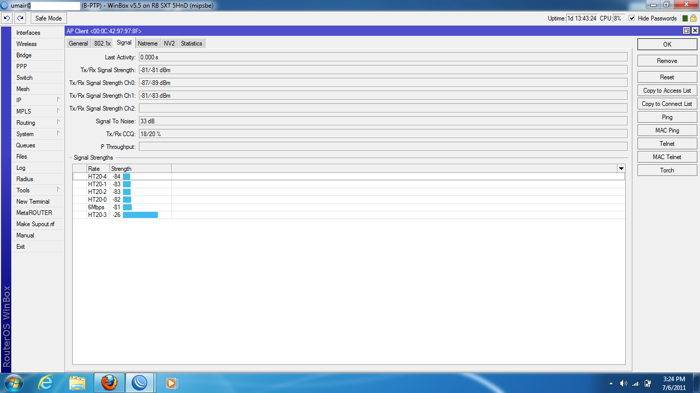

Hello i have 3km PTP link with 2 SXT in i am gateing 3mb data throughput bit in night i am gating 13mb
i cant understand the problem please help me

Your signal is not very good on 3 km. For a point to point on 3km should be around -65 or less, depending on our aerial. Most probably interference. Signal strength is usually better at night, dew to less noise, like the sun. We have a link though, where at night spot lights is switch on that is near the dish and this just kill the throughput, though nothing is noticed on the signal strength. Still contemplating how to fix this.

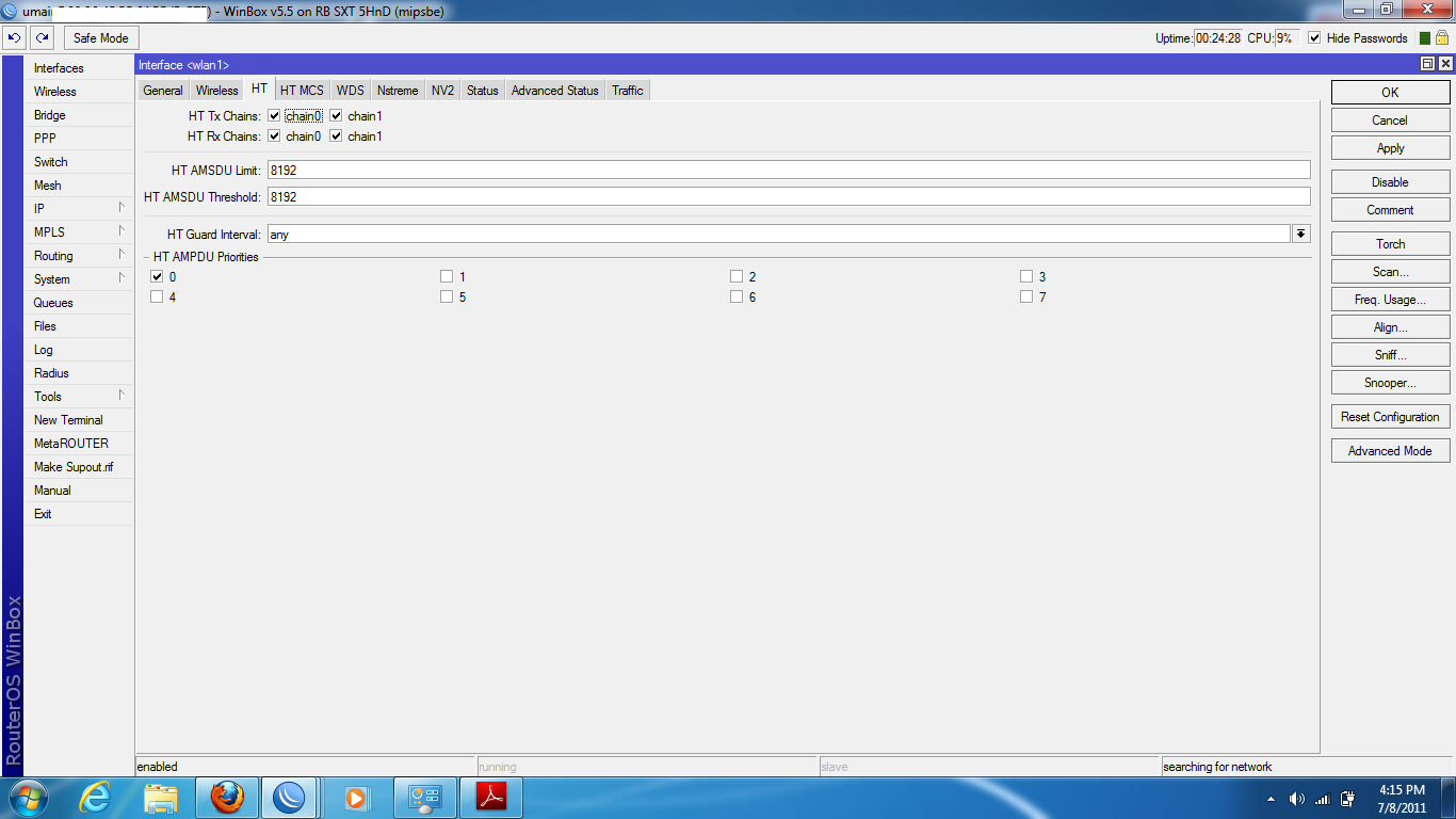

Make sure the SXT devices are correctly mounted (mind the polarization), also make sure to enable both chains in the “HT” tab of the wireless settings. See this document for mounting tips: http://routerboard.com/pricelist/download_file.php?file_id=280
Dear Normis my SXT devices are correctly mounted as mikrotik guide but i have no idia about the HT chains kindly help me
for chain settings..
