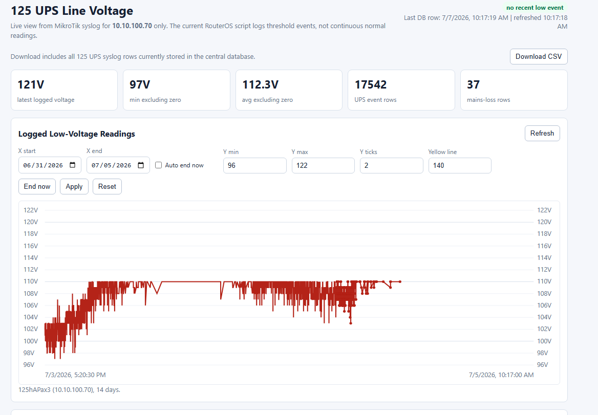

I was about to try a third time when I noticed log entries that I have had in place a long time that alert me to brown out conditions. It seems my house regularly drops before 110 VAC.

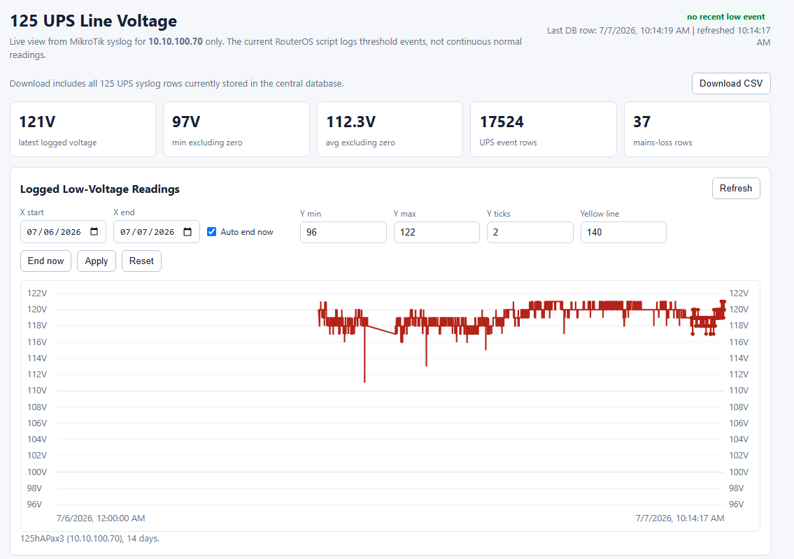

Over the holiday weekend the entire area had a black out (no power). When it came back up (36 hours later), the voltage was steadily in the 117-120 range and the ax3 was connected to the modem at 2.5gbps.

I hope the utility company's repairs actually fixed the low voltage condition, and the cause of the 100mbps connection was the low voltage condition. I'm monitoring line voltage with the ROS script and UPS.

This is the data after power was restored vs. before:
