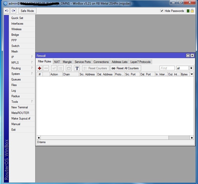

I am using RB Metal 2SHPn & RB Groove 2Hn for AP. But I am facing big problem from RB Metal 2SHPn. Where RB Groove 2Hn has signal fo 60dbi , In that place RB Metal 2SHPn has 35dbi to 40 dbi & the signal is always very up down. The configuration is same as RB Groove 2Hn. So please help me.
The screenshot doesn’t show any wireless settings. Please show us your registration table and configuration screens
I had added some screen shots. Please help me
Please upgrade the RouterOS to v6.7 and then please do a wireless interface configuration reset. You can do that by clicking on the Reset-Configuration button in the Wireless interface. Then reconfigure the wireless interface with only the necessary values.
I had upgraded the RouterOS to v6.7 , The result is till good but signal is very Up Down.
