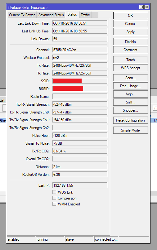

I’ve a problem on my 2Km ( no ostacle, i view the other side ) Bridge P2P realized with 2 RB911 Sextant.

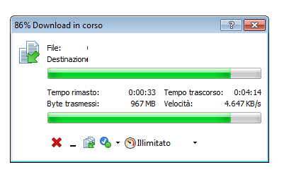

I’ve test FTP transfer: NAS ↔ RB AP - - - - wireless - - - - RB Station ↔ PC and the trasnfer in FTP is ~ 4,5 MB/S

Try 5500-5600Mhz and nstreme.
Thanks for replay.
In NStreame i’ve increase more the FTP transfer. I’ve arrive at ~9MB/s, but the internet connection non increase.

Anyway in NStreame i’ve increase more than NV2.

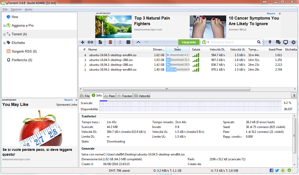

EDIT: i’ve test the internet connection with 4 simoultanly torrent download. The total tansfer is 3.2MB/s, and the total band now is ~25Mbps.
