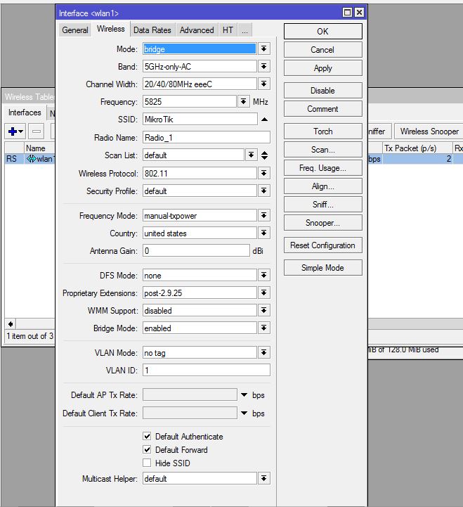

My wireless config setup. I’m totally stuck here. Thanks guys.

Try reducing signal strength, depending on the radio chipset, -46 is a bit too strong for most radios. Your radios might want to be at -56 instead. Yes there is such a thing as too strong.

CCQ and modulation bouncing, barring hardware or software defects, tells me you have noise. I would look at the scanner and frequency usage tools. RX signal levels too strong could also count as noise.
