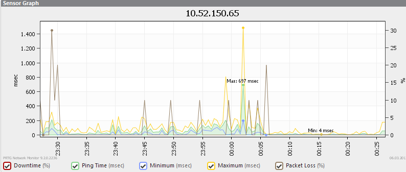

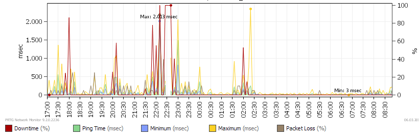

Here is ping graphs…

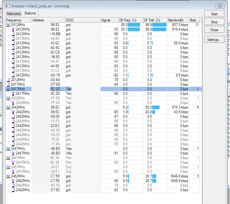

Hi !
I have news about high latency…but I don’t know what is reason for this behavior.
I power up Snooper on another card, and see that usage of Freq. are high on this time high ping, but is not visible that is any client using it, because is on same MAC as AP card is ?? Picture in attach !
What might this be ?
