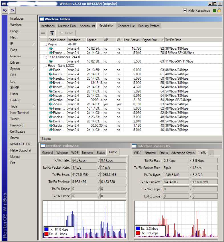

Here you can see one of my nodes, it receives signal using 5.8 from our NOC, and transmits to CPE using 2.4
18 CPEs can’t use that little bandwidth!
If I run a Mikrotik bandwidth test from a PC connected to a CPE connected to this node, running BWTServer at my NOC (connected by 5.8 to this node), I can get this morning TCP 4 Mbps down, 1.5 Mbps up, and I see that traffic at node’s wlan5.8.
I did it last night, while everyone was surfing, and I got less than 0.5 Mbps, and wlan5.8 never got more than 500Kbps.
It’s like if everyone is trying to get bandwidth, then noone gets it!
