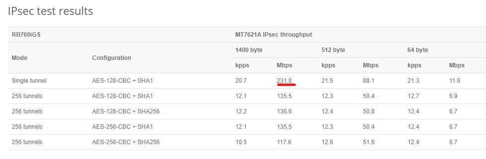

I use RB760iGS and from the datasheet we can achive more than 200Mbps VPN throughput.
Where do you see that ?

How we can know if we use HW offload or not? Here i see in the officical test result

For MT7621 (CPU on Hex S) you can find the supported modes here:
