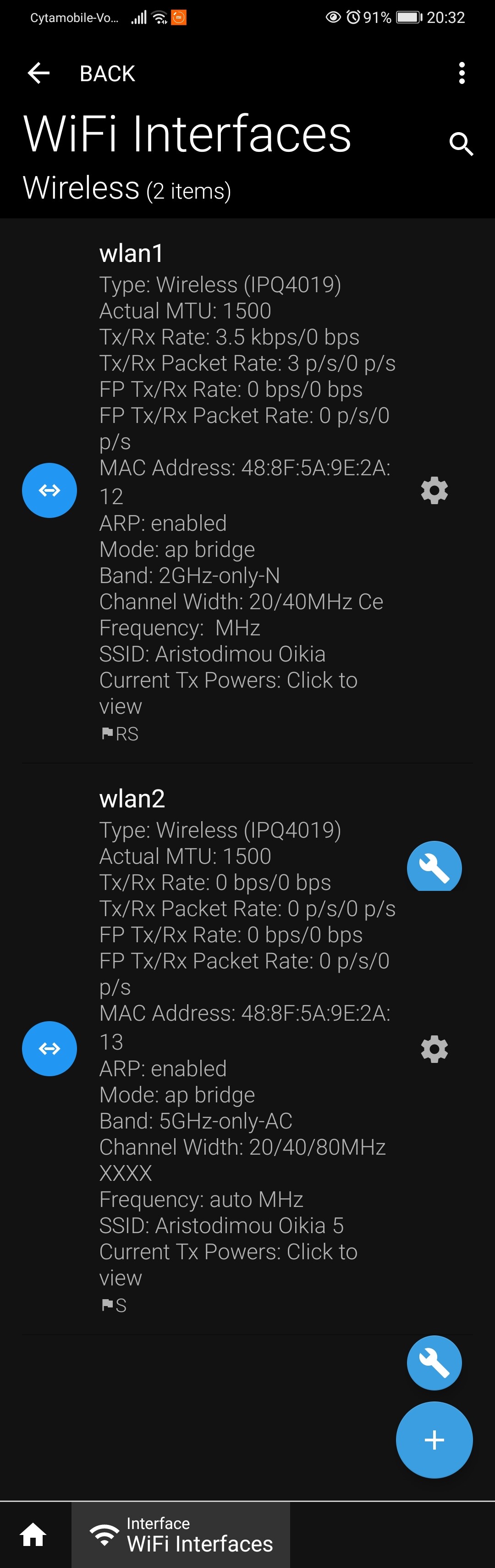

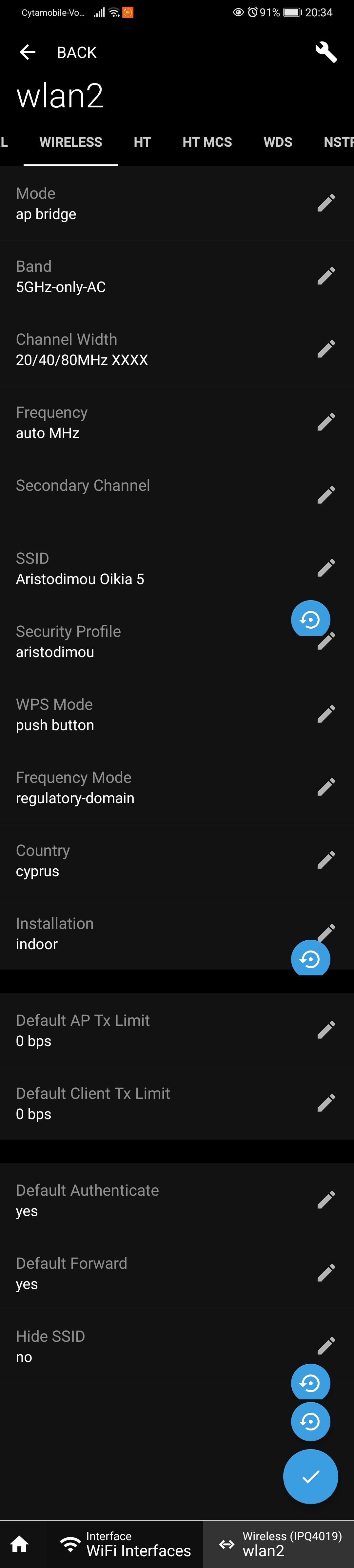

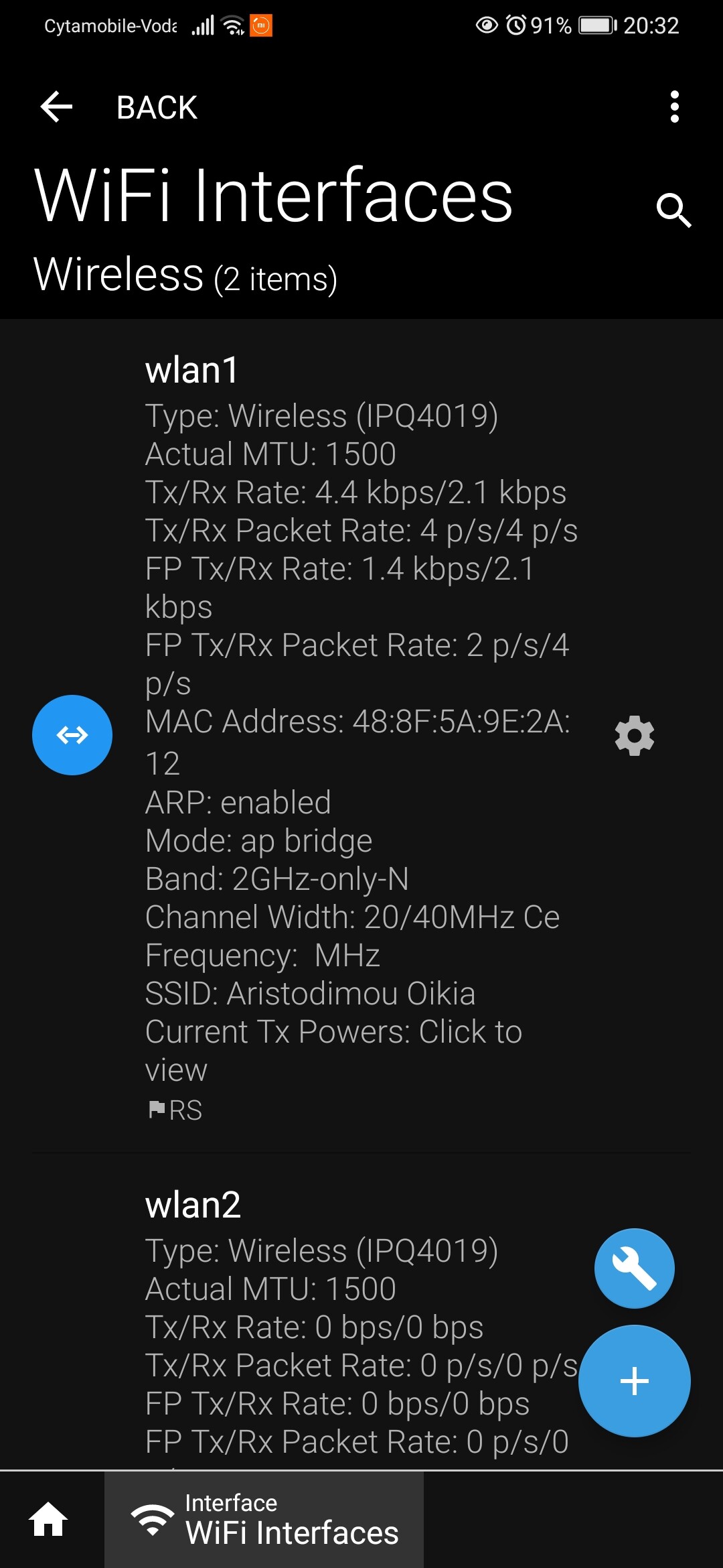

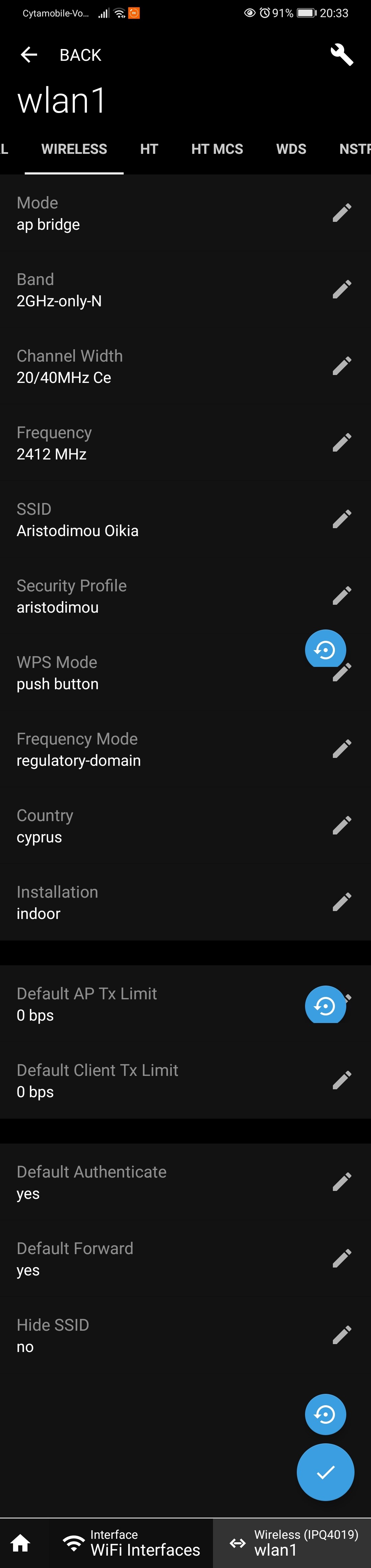

So I tried option 1 and i had low reception on Ring doorbell and almost no coverage on the ground floor. So i reverted to the original layout. I am attaching some settings if needed something more specific please ask.
OK - a few things. Appears your using the default wireless configuration. This is NOT optimal.
change your settings to:

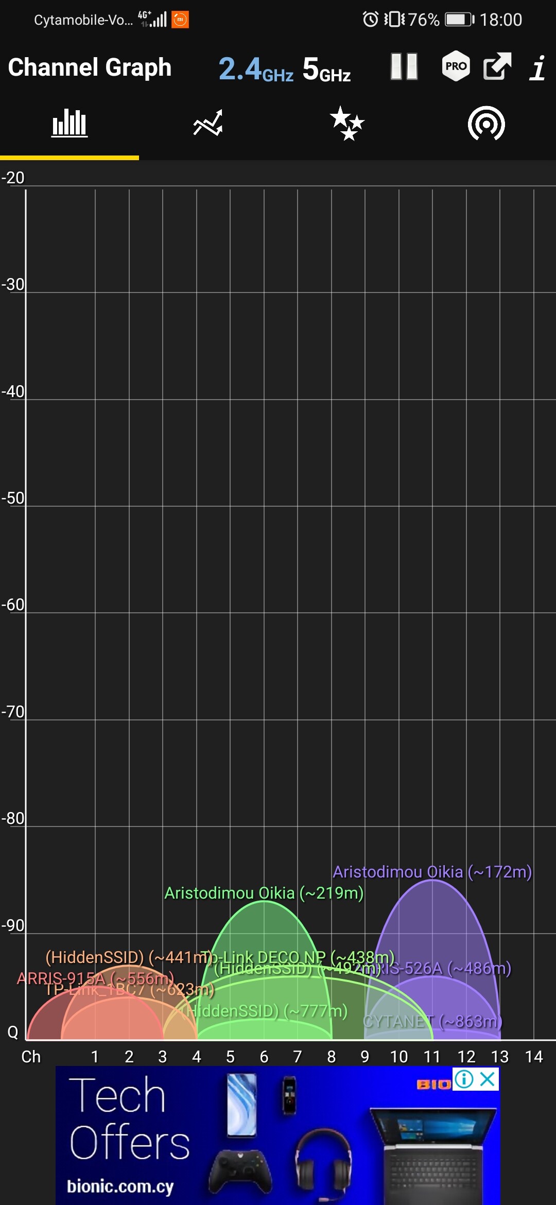

Tried those changes but no significant improvement. Attaching a status from my bedroom.
Your not going to have too much success on 2.4ghz due to the number of wlans using that spectrum.
However here are my settings for a capac…
