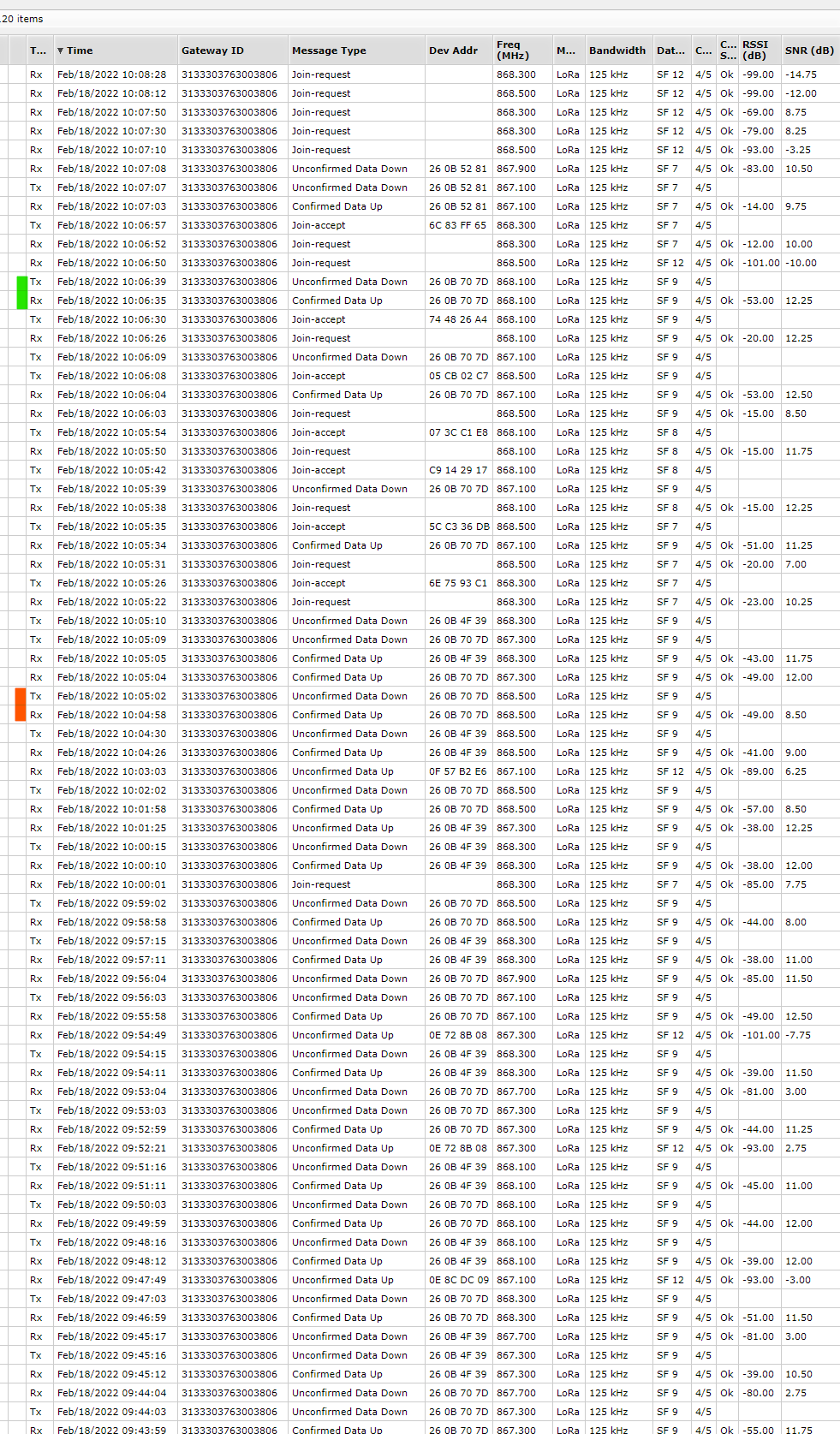

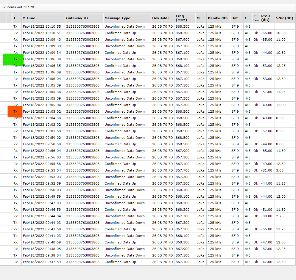

Gateway log (Mikrotik LR8) – Device 26 0B 70 7D:
10h04:58 RX Uplink LCR
10h05:02 TX Downlink LCR Answer - Gateway says it answered to the device but device never received it).
10h05:04 RX Uplink LCR - Less than 10 s after the last one. Meaning the last LCR failed.
10h05:09 TX Downlink LCR Answer - Gateway says it answered to the device but device never received it).
… LCR every 30 s until…
10h06:35 RX Uplink LCR
10h06:39 TX Downlink LCR Answer - Device received it because next ping is in 3 minutes
Multiple devices having the same problem at the same time:
  • 2 embedded MM002-EU LoRaWAN modules on devices. (26 0B 70 7D and 26 0B 4F 39)
  • 1 USB MM002-EU LoRaWAN modules with better antenna to test connectivity. USB device trying to join after the first failed LCR (26 0B 52 81)

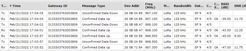

Device 26 0B 70 7D:
All devices:

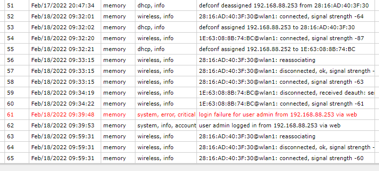

Router log:

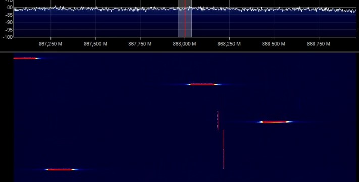

I just recorded a video showing the TX messages not sent despite being shown as sent in the Lora Traffic log.
Here is a screenshot of the video showing the RX without any TX when asking for a link check request for 3 different devices on 4 different channels:

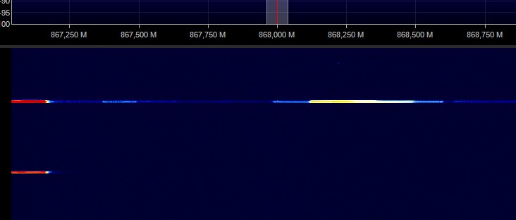

I used SDR Airspy to monitor the radio messages:
It usually looks like this when working fine:
