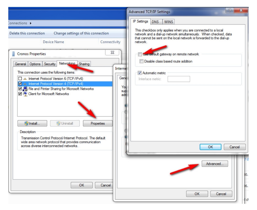

In the computer you’re using to access the VPN, you can disable use of the VPN for default route in the VPN settings.

If the computer is initiating the vpn connection, then I believe you will need to figure out how to remove the vpn from becoming the default route in that OS. Unless you were to make your AP become the vpn client, in which point you can set the route rules.
