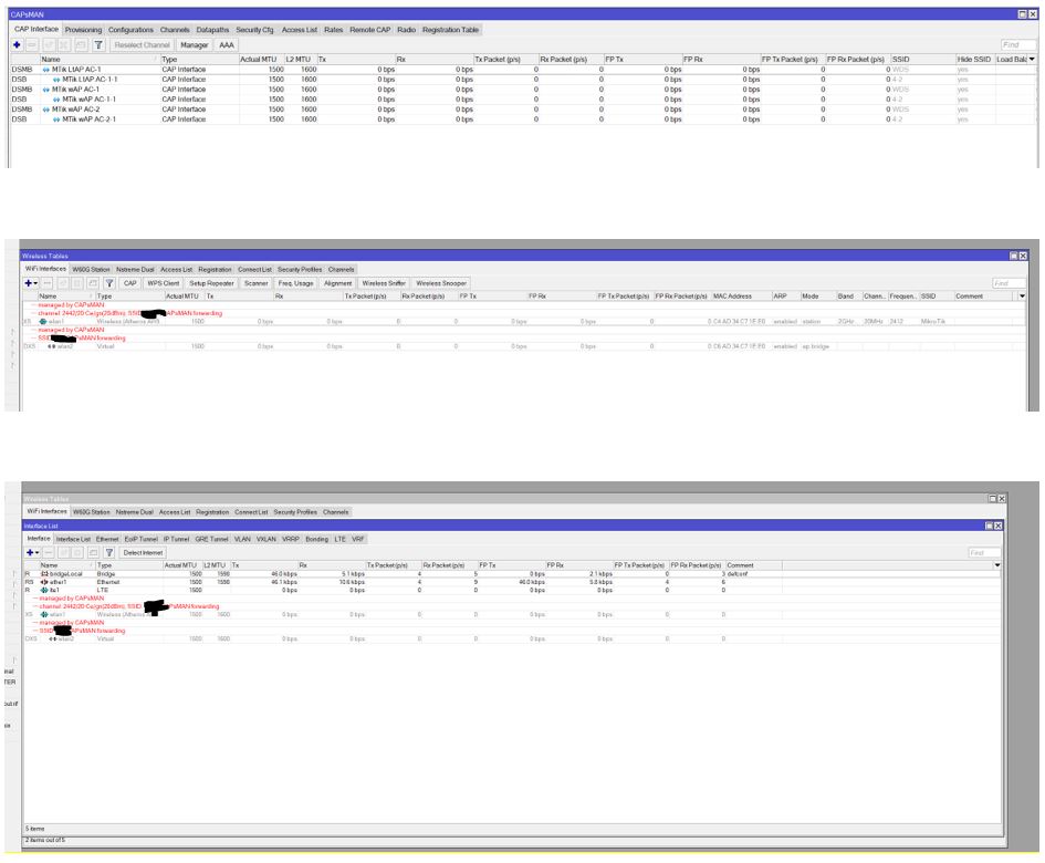

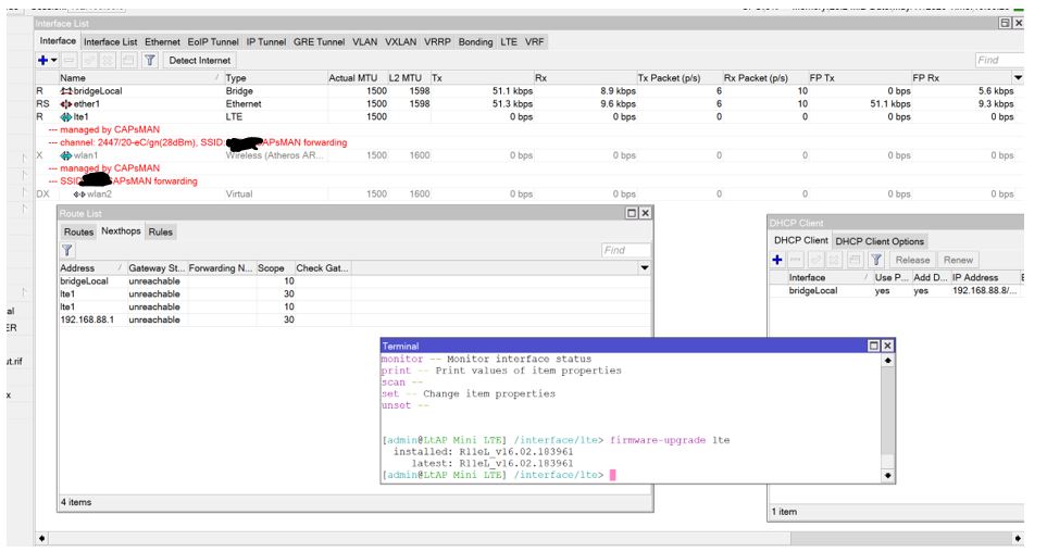

i have Hex working well, and am trying to add LTE Failover. Connecting LtAP mini i can see the LTE but can not manage in capsman, or missing routing over to working hex?? LTE is running.

The LTE is now running. I had to downgrade from 7.0vb to 6.47v60 for the LTE to "R" run. i was able to let cAPsMan run the single wifi, as i setup the LTE side.
LTE has no interface,

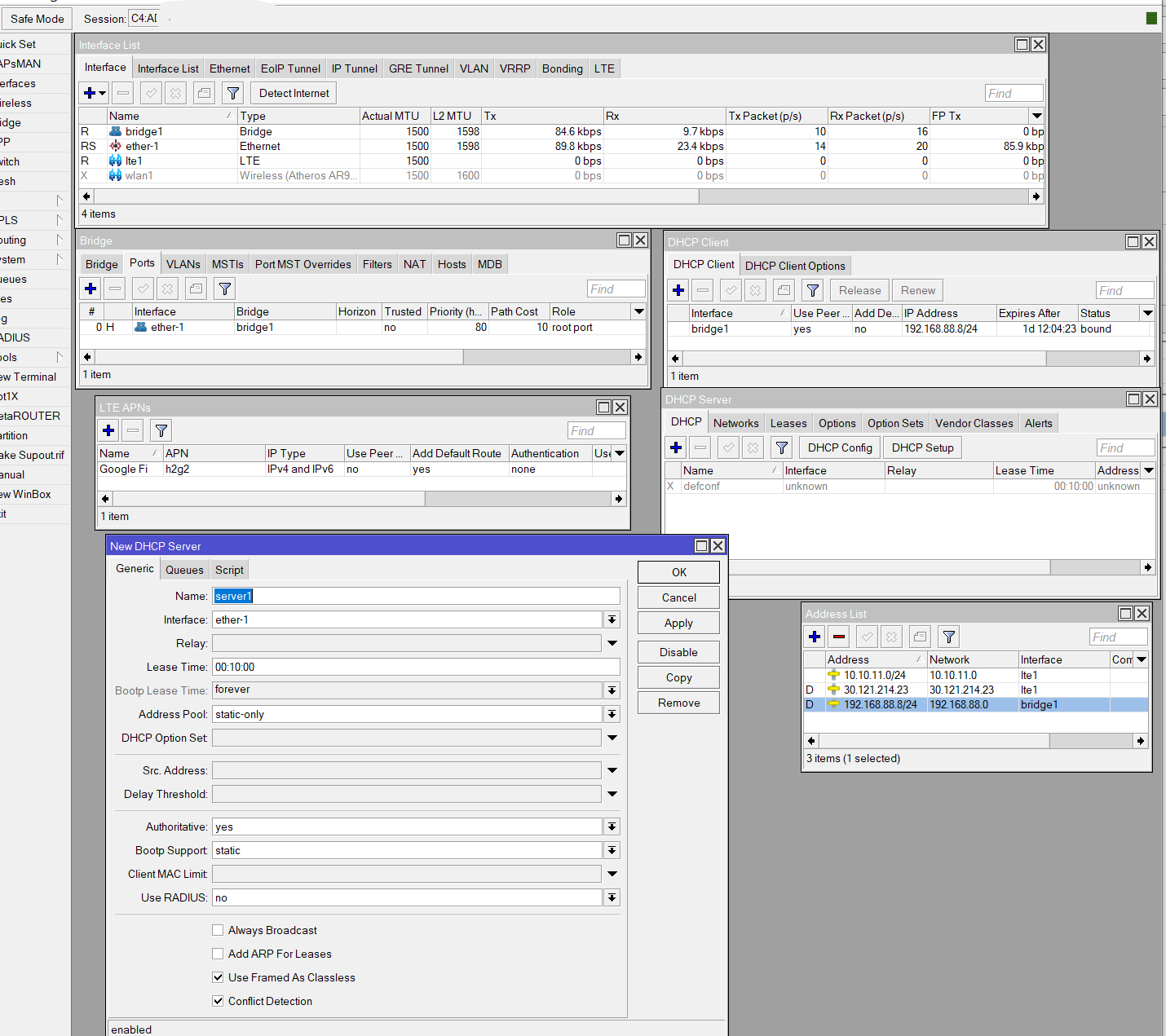

LTE is Running. Sorry. i am trying to setup the DHCP client and server. LTE interface does not come up. I have tried making VLAN’s or bridging to use LTE as dhcp server. Any bridging I change LTE with kills LTE. No longer running. This is the basic setup now.

Next screenshot after export not do any think.
I thinks I repeat that part with comments:
LtAP WAN:
/ip address add address=10.10.11.0/24 interface=lte1 network=10.10.11.0
This is ERROR, why you add that IP address at lte1 interface ? This should be receive from ISP automatical. Even if you have Public IP then you must receive it automatical, not just put it here.
