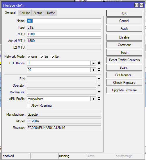

I keep getting an internet IP of 254.128.0.0 and can’t ping 8.8.8.8 for example on the lte1 interface.
LTE interface is configured for bands 3 and 20. (I have tried specifying no bands, and it picks up Band1 (-86,-100,3,-13 respectively on that band)

Cracked it - had the IP set to “Auto” not “IPv4”.
