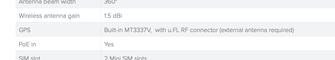

Sorry, we will try to make this line more clear:
normis, that is screenshot from brochure PDF. Im telling about product web-page.
Thank you for pointing out this problem, we will fix it in all locations
