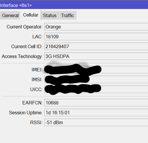

After configuring the device with the new APN settings it connects to the network like it should. Internet browsing etc. and it states ‘connected’ etc.
But it only connects to 3G. Not to LTE (4G) which it should.

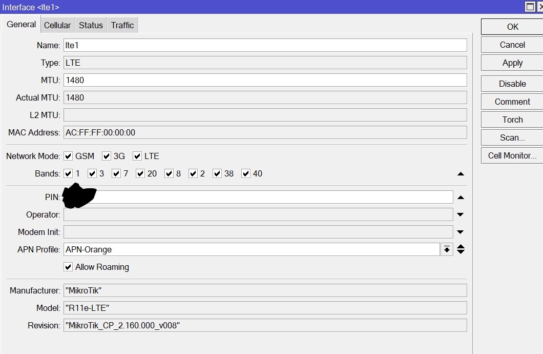

All possible options are checked (channels, GSM / G3 / LTE)

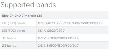

Verify that broadband modem in LtAP mini supports LTE band used by new MNO in your area. List of supported bands for R11e-LTE card (the one shipped with LtAP mini LTE kit) does contain all the usual European LTE FDD bands (B20 - 800 MHz, B8 - 900 MHz, B3 - 1800 MHz, B1 - 2100 MHz, B7 - 2600 MHz) and a couple of TDD bands, but your new MNO might be using something else (e.g. TDD B42). Typical LTE phones support much longer list of bands …

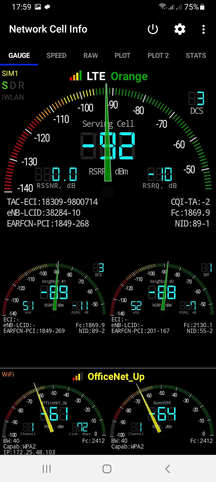

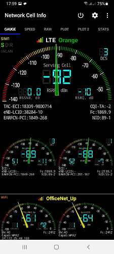

If the phone that has no problems with LTE is an Android one, install the Network Cell Info Lite app to see what band is being used by that operator - no idea what is the equivalent app for iOS. And to avoid any doubts, I’d recommend to do this test with the SIM you use in the LtAP mini.
Indeed. Every country auctions its own set of frequency bands, some auction more than others. And, BTW, it’s not “one of Europe’s main cell providers”, Orange is a group (tightly connected as in grandmother owns all subsidiaries and centralizes quite a few tasks) of MNOs, each operating in one single country. Orange Espagna is different operator than Orange France and uses different frequency bands.
Ok, installed the android app.
What is now the frequency? Is this the “Fc” number? So in this case; 1869,9 MHz, (or KHz, or GHz?)?
(Would be nice if the program would tell what all these numbers and codes mean…)
According the MT manual thes channels are supported:
So, does the 1800 (CH3) LTE FDD means this device does cover the 1869,9 frequency?
(What does “FDD” and “TDD” stands for?)

Yes, Fc looks like Frequency channel; since the fancy 7-segment digits indicate the band and Band 3 is indeed the 1800 MHz one (1.8 GHz).
Also one of the small dials below (indicating neigboring cells) says Band 1 which is 2100 MHz, so also a match.
On my phone the Fc field is missing, but I guess it depends on what information the Android version reveals to the app.
Yes, it does.
Frequency-Divided Duplex uses a different frequency for network->client and client->network direction, which means these transmissions can take place in parallel and there is no need to coordinate them in time; this is how traditional radio systems, both analog and time-division-multiplex, usually work as they are designed for symmetric traffic volumes; Time-Divided Duplex means that the same frequency is used for both direction in turns (this is how WiFi usually works). Since a typical mobile phone user uses much more download than upload, TDD is somewhat more efficient in bandwidth use for this kind of application because a given amount of spectrum, e.g. 20 MHz, can be distributed between the two directions in different ratio, whilst for FDD, the same amount of spectrum is always shared 1:1. But for TDD, the time synchronisation of the clients to the network must be very precise to minimize the guard times needed for direction reversal.

So now to your actual issue, since it doesn’t seem to be a band support issue, what exactly does /interface lte monitor info 0 show on the LtAP mini, esp. the field access-technology?

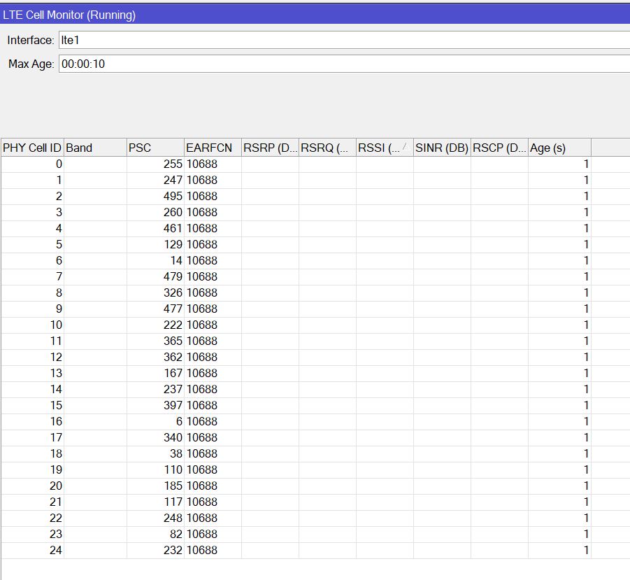

Oh, and this is a screenshot of the cell-monitor (there is no menu with only “monitor” in ROS v. 4.49.1)
I would say let’s start from pulling your R11e-LTE into 2021 as it is almost over now. As I could not find how to do firmware upgrade using Winbox, you’ll have to try using the command line (you can get a command line window by pressing the [New Terminal] button in Winbox).
Make sure that the power supply to the LtAP mini will not interrupt (even if you had to power the LtAP mini from your car battery), and then run
/interface lte firmware-upgrade lte1 upgrade=yes
in the command line window. And pray the whole time until the LTE card re-appears.

Yeah, but the R11e-LTE has its own firmware (don’t confuse it with the RouterBoard “firmware” which is actually a bootloader for RouterOS), and yours is running MikroTik_CP_2.160.000_v008 whilst the up-to-date one is MikroTik_CP_2.160.000_v018.
Ok, but your line; “And pray the whole time until the LTE card re-appears” doesn’t make me very confident in upgrading. If it doesn’t I’m doomed… what would be the benefit of the new firmware?
