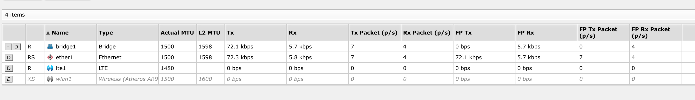

But you already have a route towards the internet (it should be provided by the lte1 interface by itself), the one in your screenshot:
DAS 0.0.0.0/0 lte1 reachable
is telling the router that any address in 0.0.0.0/0 (all the addresses) should go through lte1.
From terrminal, you can check with:
/ip route print
So it could be some rule in your firewall that prevents it to work, but you have (I hope temporarily) all firewall rules disabled, so it must be something else.
In another screenshot you have the wlan1 interface as XS, the X should mean “disabled”, but in the configuration, you have it as disabled=no, the S should mean that the interface is the slave to the bridge (bridgewlan), but the bridegewlan is nowhere to be seen in that screenshot :confused: .
But from the configuration, it seems like there is a setting missing in /ip dhcp-server network, are you actually getting an IP in the 192.168.89.x range when connected wirelessly?
And you have no DHCP server on the ethernet bridge, correct?
