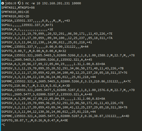

Hey nzmikec,
I have a LtAP mini and can confirm the same problem (routeros 7.5). I did some testing and managed to make the GPS output go via remote-access again. Did some trial and error to duplicate. I tested with normal reboots as well as removing power for a cold boot. So far so good although I will log a support ticket with Mikrotik as we have a bug here. So a fix later on might make this redundant.
I setup a script to do what is needed and a schedule job to execute the script after a reboot. This script can also be excuted by pressing the mode button. Let me know if it works for you.

Hmm, I’m getting failure: device is busy, check /port when I run this script.
I’m not even able to enable remote access on the serial port. I am using the LTE version if that makes a difference:
LtAP mini LTE (R11e-LTE-US)
The error
is correct. The last command of the script enables the gps to use the serial port which fails as it is already in use for remote access. This is the trigger/bug that internally connects the GPS to serial0. Then connecting to the port specified for remote access gets you the GPS data.
I have only tested this running RouterOS 7.5. No idea if this will work on v6.
After some testing this morning I noticed that sometimes the scheduler executes the script very early in the boot sequence. I inserted a 30 second delay to let the LtAP settle. I also updated the script to log when it’s running and cycle the gps port before enabling. There is no error message now as it is executed in a do/on-error block.
