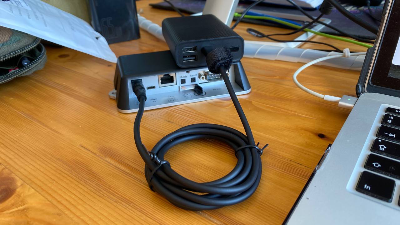

USB type-C with PD to DC cable fix problem
