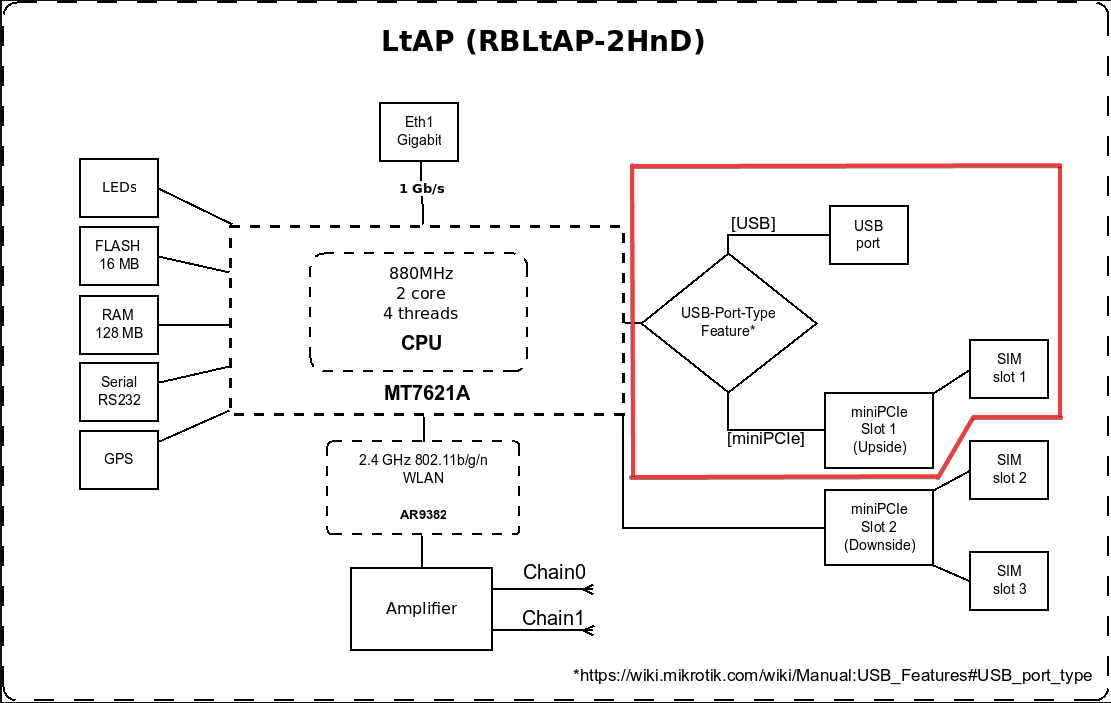

LtAP no modem in LTE interface
I got my new LtAP and wanted to test LTE modems. I tried with two different R11e-LTE modems, both are working in my RBM11G and RBM33G routerboards.
LtAP shows no modems in LTE Interface tab. I tried with both PCIe slots and with 3 sim slots. Never showed a modem.
Any help?
I did a firmware upgrade on my modems to 0.12 and now they appear if connected to the bottom PCIe slot.
But the upper slot still doesnt work.
The manual says that upper PCIe slot is one the same data line as the USB port, is there any jumper I have to switch?
/system routerboard usb set type=mini-PCIe
did the job.
Hey man, I can’t believe it!!! Finally my R11e-LTE-US interface appears on my interface list!!!
I never saw this command before! Very useful!!!
A lot of thanks Gerbaum!!!
I know that it’s not new but I think for future person who show this post this will be good info.
WIKI: https://wiki.mikrotik.com/wiki/Manual:USB_Features#USB_port_type
/system routerboard usb set type=USB-type-A
