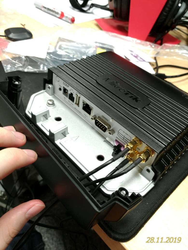

You can use LtAP with external connectors for either WiFI or LTE depending on what you installed in device. As you can see LtAP has cutouts for up to 3 SMA connectors (3rd one is on the opposite side of front panel, next to power jack). I for example use LtAP with high power wifi 2.4 in car with external antennas for long range wifi connection (used to dump high volumes of data collected while driving to base station)

Hi lapiso
That that rely look cool, and ya it is there so I gonna order for install.
It will be nice if this was made in the unit so you both internal and switch for external but this will do the work.

I think it wasn’t clear from brochure / photos whether LtAP has actual cutouts for external SMA. Especially if someone never used such cutouts it may not be obvious that those circles are supposed to be removed and used as mount points for SMA pigtails. At first I also didn’t know that, I thought it’s just for ventilation purposes xD
For automotive use cases LtAP is vastly superior starting from easy power delivery using 12V automotive tail, having RS232 and GPS as well as multi-SIM.
It is described in the quick guide of the product. MMCX connectors for external antennas…
