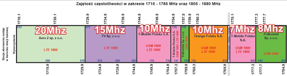

Additional you can use your government webpage to find a assignation of Band’s per real ISP like in PL B3 is divided as:
