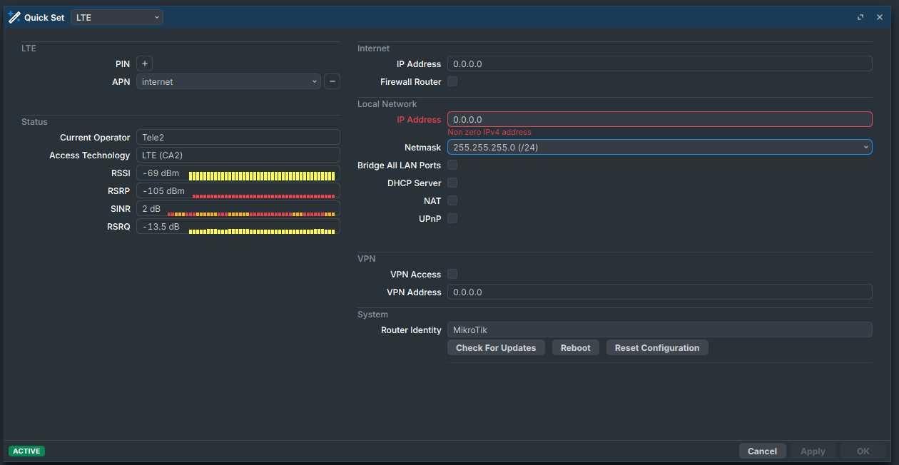

Now I have installed the wAP ac LTE6 kit, an set it up using LTE passthrough, and a VLAN for managemnt access.

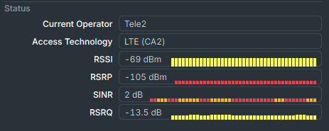

It works well and I guess have sesonable reception when I have i indoor, and I get about 60mbps download speed and 35mbps upload speed.

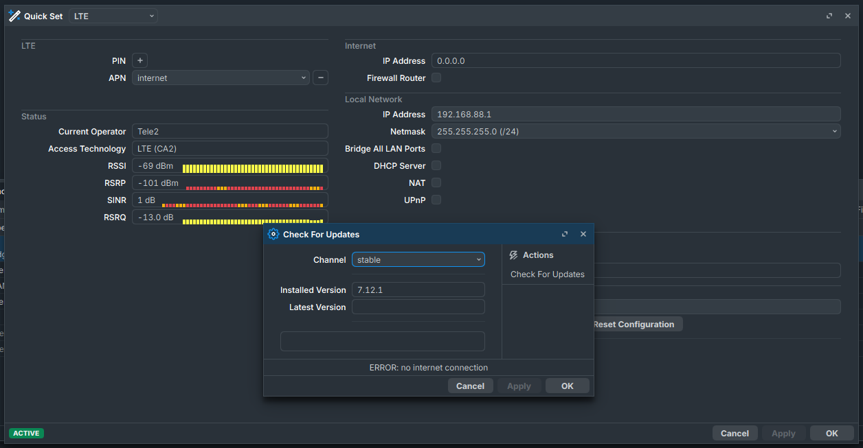

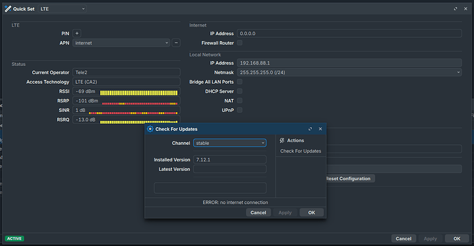

But the issue I have which I noticed when checking for updats is that the router itself doesn’t have internet connection.
I guess I somehow need to add a gateway to get Internet connection for the router itself?
I believe that is one of the issues of using it in passthrough mode, the device has a 0.0.0.0 internet address in your screenshot.
Yeah, I noticed the Internet IP Address.
This is my first experience with a MIkritik router so I’n not at all pamiliar with the management interface.
What I imagine would be possible is to set upt the VLAN interface to get its IP adress from my Unifi cloud gateway thrugh DHCP, which means it will get gateway and DNS that way.
But I don’t see any options to set up the IP address for the VLAN to be handled by DHCP, any ideas where I can find that?

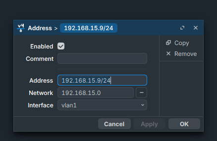

This is where I set up the IP addres for the VLAN, under: IP → Adresses.

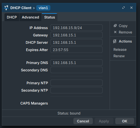

Aha, it was there right in front of me under IP → DHCP Clients.
Now the router gets gateway and DNS from my Unifi Ccloud gateway.

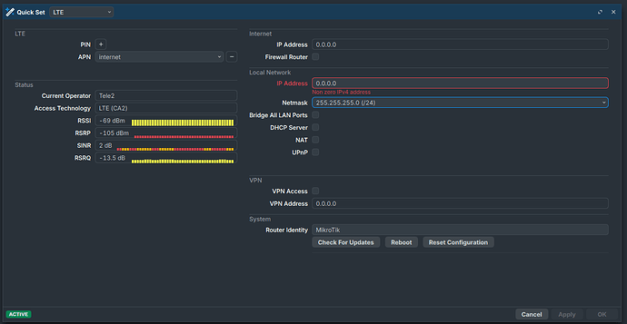

I still have Internet IP Address: 0.0.0.0 on the Quick Set page, but Internet connection is established.

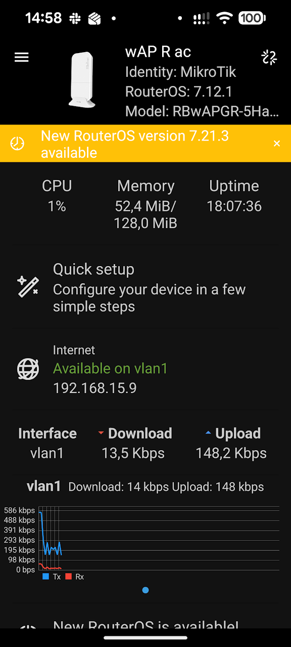

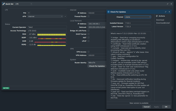

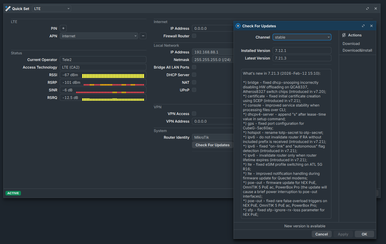

If you look at the screenshots you’ll see that the router now have Internatr access(it spotted new software)
But sure I can upload my config, file is attached.

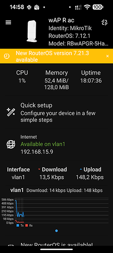

And when connecting using the Android app, it clearly say that Internet is available on vlan1, so maybe there is some kind of bug on the Quick Set page so Internet access is not spotted.
This is what the app looks like:
Oh, I didn't notice that the screenshot was from Quickset.

Yep, it is fine, the device is in passthrough mode, so no issues with bridging/switching (on VLAN1).
The Quick Set very likely doesn't even consider the VLAN interface.
Since you don't have the firewall in input (and also NAT disabled), everything works so you can keep everything "as is".
The addresses and routes are assigned Dynamically by the DHCP, the ether1 by the LTE and the VLAN1 by your local DHCP server, so everything is OK.

Of course it depends on location and your ISP, but 60/35 don't sound at all a bad result, for a Cat 6 device, testing it outside costs nothing, so it is worth it, but an external antenna seems to me an unneeded complication (unless you do it for fun, of course) and has a cost, probably around 100 € or so, plus the pigtails.
If it was your only and "main" connection to internet I would understand, but as a secondary, backup wan?
Anyway, JFYI:
Yeah, maybe external antenna is not woth the hassle, but I would like to see green in the status, or at least not red or orange.
