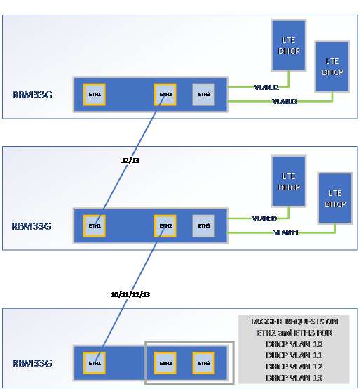

For several days now I have been scratching my head on how to get the following configuration to work with VLANs instead of Mangle rules. At this point I am even wondering if it is possible with only VLANs. The setup is as follows:
I have 3 RBM33G routers
2 of them have 2 x LTE modems in them (4 in total)
The modems are EG25-G which give out a private IP address in the range 192.168.225.0/24, 192.168.225.1 being gateway.
The purpose of this setup would be that I can select a connection to any LTE modem based on the VLAN ID passed when connecting to the RBM33G. Eg If I set the interface VLAN to 10 it will get an IP address from that specific LTE modem.
I tried using passthrough on the LTE APN to a VLAN Interface but I can’t seem to be able to access it down the line. I tried all possible combinations I could think of but somehow I can’t find the LTE modems and get an IP address from them. When configuring the LTE modems without VLAN the LTE interfaces get an IP address and work when using mangle rules, but the whole point would be to avoid that … or are my ideas too simple :-).
Thanks for sharing your thoughts on the feasibility and maybe hint which is the best way to go from here

@Zacharias: I think there might be some confusion as ETH1 connects to the LAN and the LTE modems are on the RBM33G board as mPcie. I can’t set a VLAN on the LTE interfaces and the Bridge doesn’t see LTE1/LTE2 as ports.
I don’t think you can set VLANs on LTE interfaces because LTE interfaces are not L2 ethernet interfaces.
What in particular is that you want to achieve?
There may be some issue with LTE passthrough and bridge VLAN filtering - recently seen with a wAP LTE kit, but I couldn’t investigate fully as it was remote.
If you are only using the ethernet ports on the RM33Gs containing the LTE modems as an interconnection trunk (the top two in your picture) just turn off VLAN filtering on the bridge so it acts as an unmanaged switch, the LTE passthrough to the VLANx interfaces tags the modem traffic and you have access to the Mikrotiks untagged.

In post #4 @OP is mentioning mPCIe modems which provide lte interfaces and he’s not able to add those to bridge. So I gather it’s not about LTE pass-through after all. But I might be mistaken.
OTOH pass-through setting seems to be property of lte interface itself. Explanation is in interface LTE manual.
