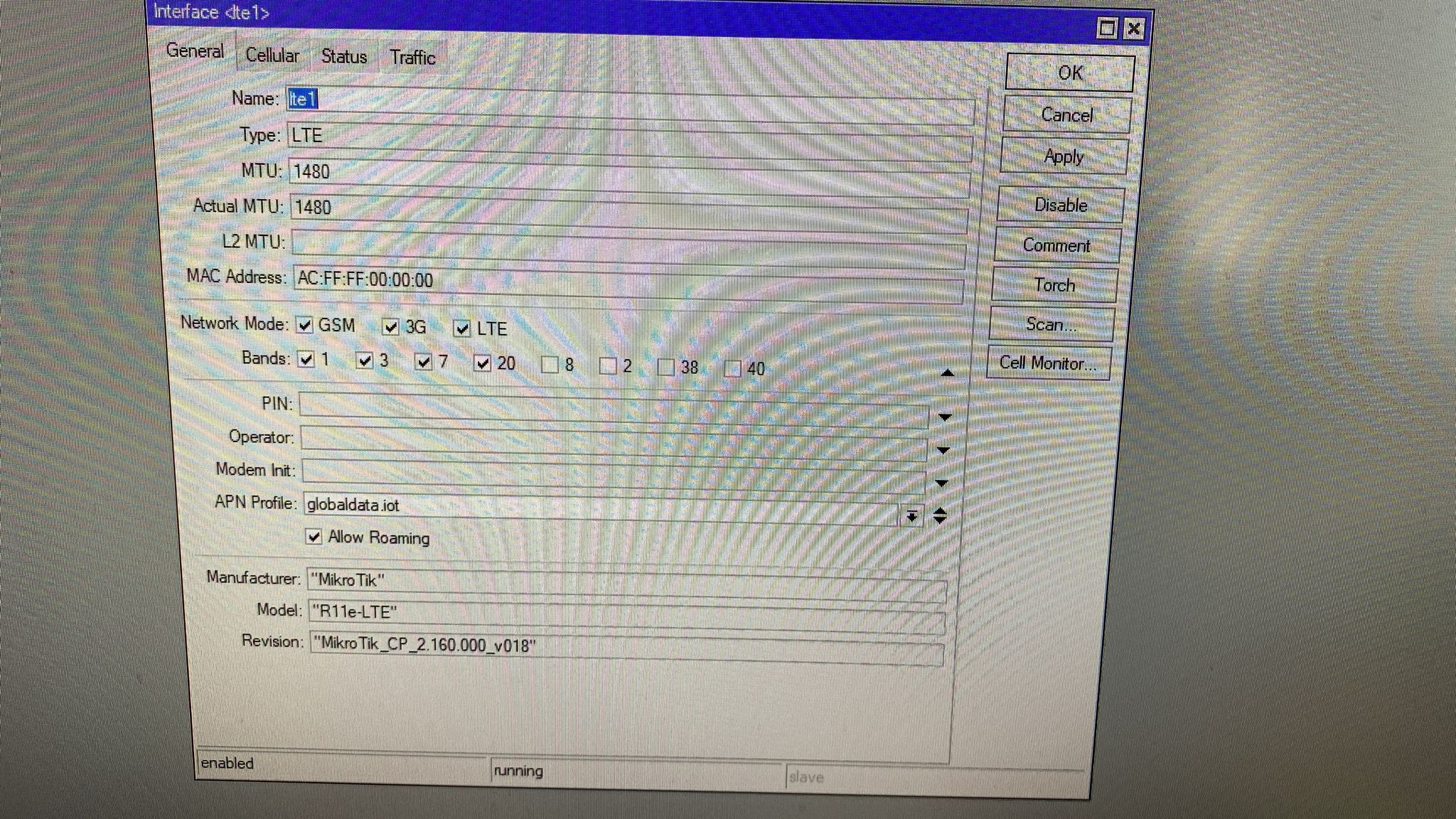

In the main we tend to use LTE Cards on RBM33G boards. We have around 600 installed in and around the UK. We always use eSims from the same provider and majority all work fine but occasionally there is an issue where the eSim doesn’t seem to roam correctly and refuses to change or hunt for the best provider following a reboot. The eSims are all capable of 2G, 3G and 4G and will use Vodafone, O2, Hutchison Three or EE as a carrier ( we are UK based ).
All routers have the roaming box ticked and all run on either the latest or at worse last firmware version which si eh same for the modem FW also..
My question is does anyone have a similar setup where an LTE ( or even 4G ) card is used with an eSIm and do you have problems or does anyone know of any problems on RB OS that will cause roaming to have issues. As mentioned, most all work fine and we never have a problem, its only when it goes wrong that it becomes a bit of a nightmare to resolve and often we have to swap SIMs out to force a new connection.

About just roaming we can do a scan listing… to grab MCC nad MNC and select it by /interface lte set lte1 operator=

I am confident roaming is working because when a new SIM is used it will hunt for the best network and connect. Is there a way to check roaming via AT commands.
The problem we have is once the router has connected first time to a network it doesn’t seem to roam again when rebooted.
The routers are built in our warehouse and then installed at a later date so when moved we need them to check again for best network and also when rebooted. Is there a way to force this?
