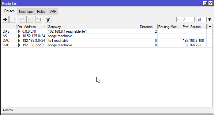

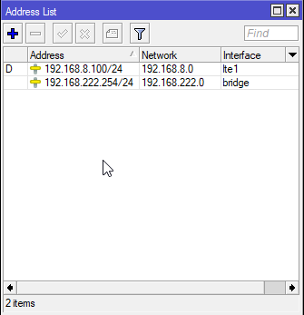

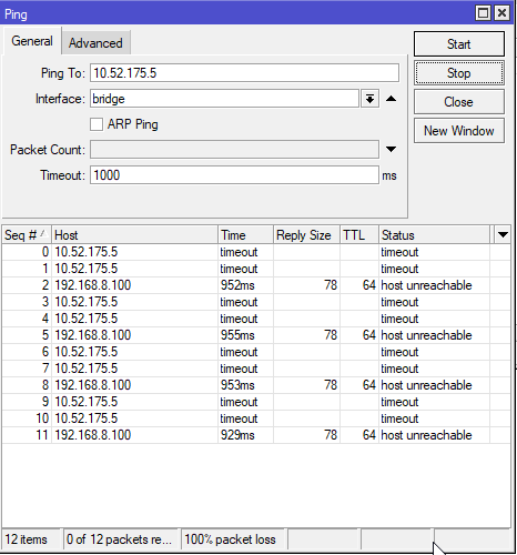

we use Mikrotik Hex S Routers on multiple Sites to connect the local network to a network in our datacenter via IPSec. This works fine. But now we need an LTE Fallback on one of these Sites. We plugged in a Huawei USB LTE adapter and internet access works. When the Eth1 Interface loses access to the network it automatically creates a route to route 0.0.0.0/0 via lte1 which seems fine to me. The IPSec-Tunnel has to be restarted because of the new IP adress, but that is ok, i will find a way to do this via a script. The only thing i haven’t managed to get to work is the outbound IPSec Routing. When the IPSec reconnects via LTE i can ping the router from the remote network, so there is an active connection. But when i try to reach this network with a connected device it times out. When i use the ping tool on the router it report timeout twice and then a message “Host 192.168.8.100 host unreachable”. The 192.168.8.100 is the IP the Router has on its lte1 interface, the lte adapter is 192.168.8.1 . When i first read this i interpreted it as the router trying to reach the VPN Network via lte1 which doesn’t work. The VPN Network is only accessible via bridge. Using the “interface=bridge” option when pinging didn’t help either. I assume it is a routing problem. There is the dynamic route to 0.0.0.0/0 via lte1 which works for internet access and then i created a static route to the VPN Network via bridge. My static route has the Distance 1 so i would assume, it would use that route before the dynamic lte route which has a distance of 2. I searched the internet for tutorials on how to do this and everything seems right, but it doesn’t work. I don’t think there is an error with my IPSec configuration, since it works fine on Eth1 and inbound traffic works through lte.
I attached some screenshots of my config. I am thankful for every tip you might have.

First of all, instead of posting “some screenshots”, post a complete configuration following the hint in my automatic signature just below. If the router to which the Hex S routers connect is also a Mikrotik, post its configuration too.

Your LTE is being given a private IP address, not a routable Internet address. Are you sure your IPsec VPN will work over that sort of connection? Some of the protocols, esp for example, are not NAT friendly.

sorry for not answering anymore. The Problem solved itself with the latest firmware update. I also wrote a script to check via pings which interface is online roght now and switch automatically if one fails.
