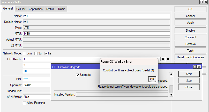

It does not seem to existing. Both methods failed 1.11.2025 I run SXT LTE6 with 7.20.2, packages and routerboard are updated, but "R11e-LTE6" firmware is stuck on R11e-LTE6_V038 and does not upgrade it into R11e-LTE6_V039, says object does not exist.
Accidentally, I updated modem SW on AC3 LTE running 7.20.2 last week from V038 to V039.
Are you sure you have LTE connection at the moment you try that upgrade ?
I get this
