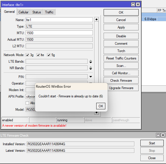

In Winbox I see LTE FW version RG502QEAAAR11A06M4G but there is always a notice that a new version is available. If I am checking FW status there is no newer version available but I always get this information:
/interface/lte/print
Flags: R - RUNNING
Columns: NAME, MTU, NETWORK-MODE, APN-PROFILES
NAME MTU NETWORK-MODE APN-PROFILES
;;; A newer version of modem firmware is available!
0 R lte1 1500 3g x.x.x.x.x.x.x
If I want to do an upgrade the router says I am up to date.
Any idea why I get the information about a newer version?
Thx Richard
This is my problem. Here the screenshot with:
result of pressing “Check firmware”
result of pressing “Upgrade firmware”
notice that a newer version is available
Thx Richard
Open new terminal
/interface lte firmware-upgrade lte1 upgrade=yes
thanks but there is the same output:
[admin@MikroTik] > /interface lte print
Flags: R - RUNNING
0 R lte1 1500 3g xxxxxxxxxxxx
lte
5g
[admin@MikroTik] > /interface lte firmware-upgrade lte1 upgrade=yes
failure: Firmware is already up to date
Talk with Mikrotik support
