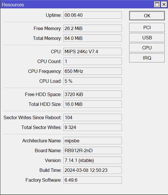

Just had this issue with a RB912R-2nD.
No matter what, the LTE interface did not show up.
Might be a fluke, but after going to System/Resources and clicking on USB, initially it only showed one device named RB400 EHCI.
After a couple of seconds, the 2nd device named R11e-LTE appeared and the LTE interface was now online.
Try this before going nuclear and reset or RMA.
later edit:
Seems that selecting the modem as MBIM instead of Auto fixed this issue on another RB912R-2nD.
5 reboots with modem Auto = no modem even after 5 minutes of waiting
5 reboots with modem MBIM = always modem right after reboot.
Set the modem to Auto and did a couple of more reboots = no modem again.
Something is messed up with this setting, at least on this model.
