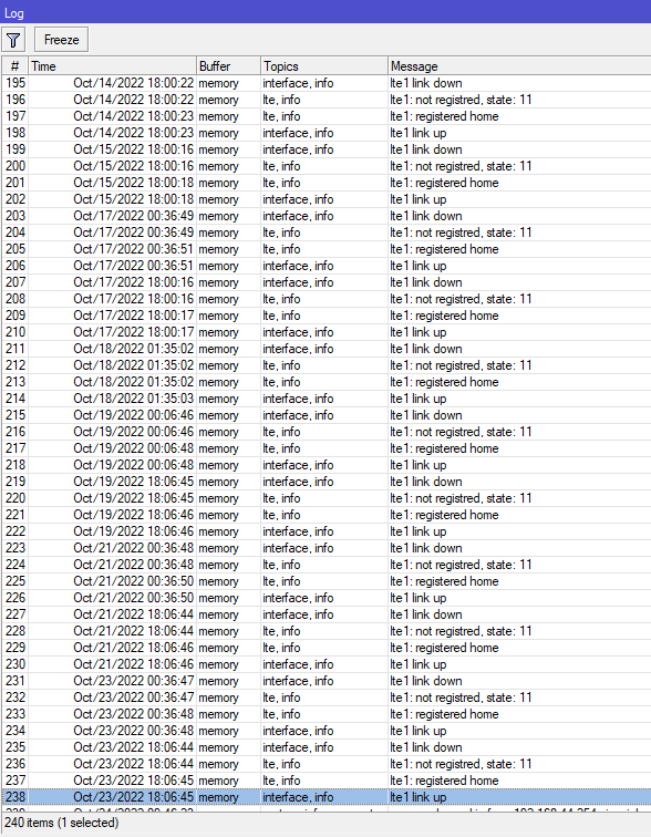

We have a problem with the stability of the LTE connection on our “R11e-LTE” devices. The LTE link goes down, then up again once or twice every 24 hrs, usually at the same hour. We are running RouterOS 7.5 and LTE FW R11e-LTE MikroTik_CP_2.160.000_v020.
Logfile:
Anybody with the same experience or a solution to the problem?
Probably it’s switching LTE bands on the same tower. For me helped setting band parameter.
