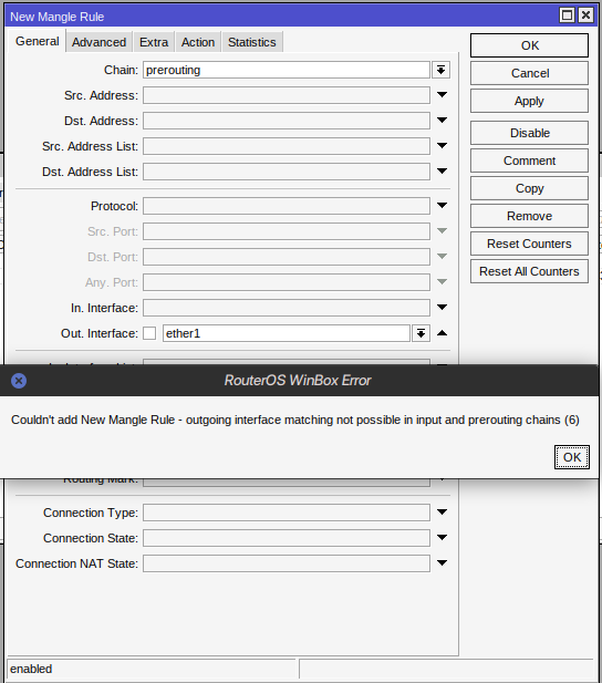

EDIT: Interestingly, it appears to apply to the LTE device. When I tried to apply it to the hEX, I got the error below. Ether1 is the WAN interface, but even changing it to bridge made no difference. However, it did apply to the LTE device in passthrough mode. So it’ll be interesting to see whether it works going forward.

The article, linked in post #3 above, says that mangling rule should go to chain=postrouting …
Thanks for that, much appreciated.
The config I ran for the hEX was a direct cut and paste from the article, which Winbox rejected it as explained above. I then manually inputted the config using the UI (not term) and having just checked, it is chain=post-routing. Image below shows CA working where it wasn’t with this provider before the config was run.
