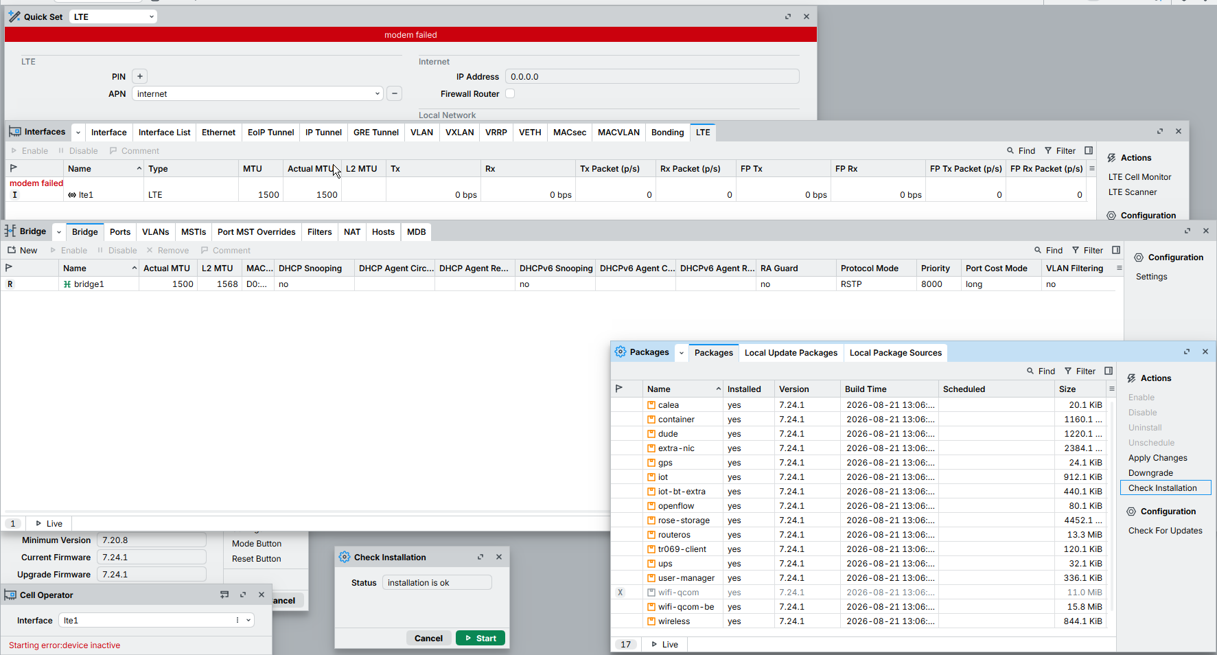

Issue Summary
I am troubleshooting a recurring problem where the router reports that the LTE modem fails to start. The system shows the status “modem failed”, indicating that the LTE module does not initialize correctly. At the same time, the router behaves inconsistently: Wi‑Fi interfaces appear active, bridge ports look correct, and the DNS cache fills normally, but the network remains unstable and certain terminal commands produce unexpected results. The computer connected to the router also experiences unreliable connectivity.

What's the model of the MikroTik/LTE?
Do you really need all these packages?
I am not aware of any Mikrotik wifi-qcom-be device with built-in LTE modem right now. Wondering how these wifi interfaces are in a running state.
And please, when using AI, instruct the AI to check itself.
Attempted to restart the LTE modem and related subsystems, but the “modem failed” error persists.
Something like that is AI :poop: How (which commands) did you actually "restart the LTE modem and related subsystems"?
Why do u have all the packages enabled?
Uncheck everything but the packages that u absolutely need, this is a huge waste of ram and cpu and can cause driver issues, which can be a part of your problem.

The problem start before I add those packages, yes I know I waste ram and CPU, just try if someting worked out. I get rid of those I dont need now.

No not an AI, and it was start before I install packages. I’m still a beginner when it comes to professional‑grade routers, but I’m learning fast. I really like the LTE version — it feels stable and good to use — but it becomes a bit unreliable after upgrades or configuration changes, which is why I ended up testing everything I could when the issue appeared.
Chateau 5G R17 ax.

Yes... BUT if you write the commands you tested... then you also have to write what errors they gave you...
Tip: I'd avoid writing the same thing multiple times... No?...
Start from zero for avoid any config issue.
Use netinstall and install only routeros and wifi-qcom packages without all unneded packages.
(wifi-qcom-be is for another device "be", this is "ax")
And when you write, make a point of specifying which device you're talking about,
(and what version of software you're using).
