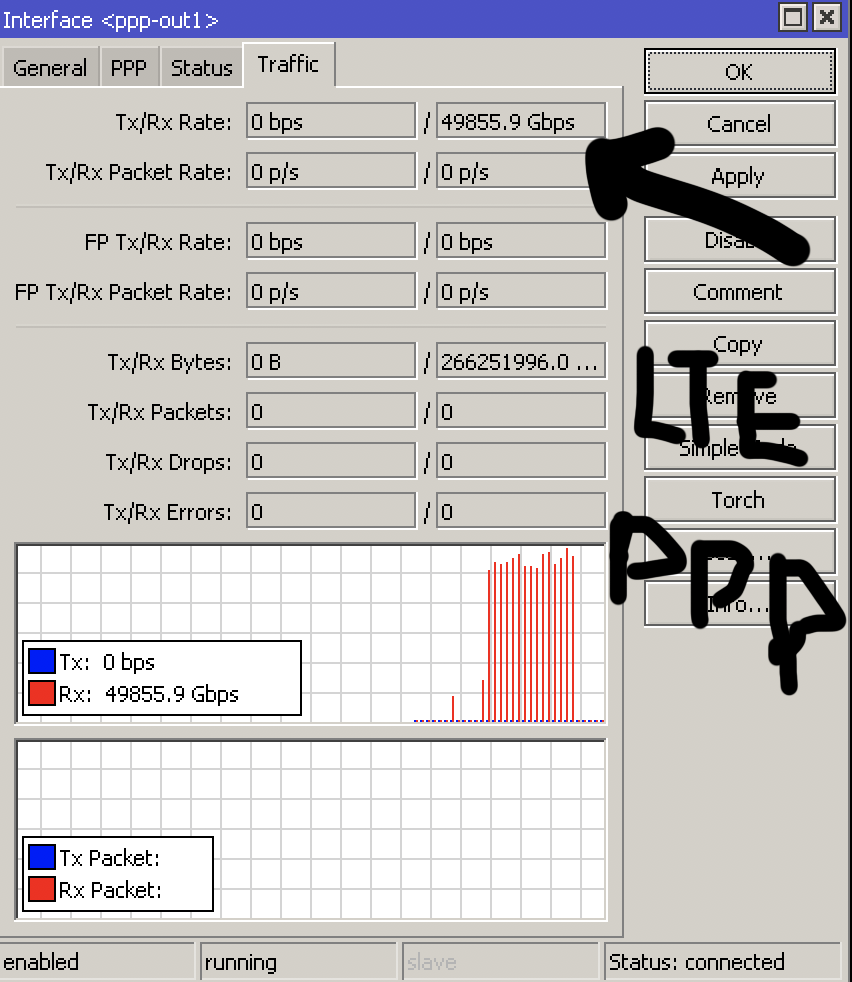

I tried the firmware and noticed this
interface ppp speed is considered not true) in gigabits!

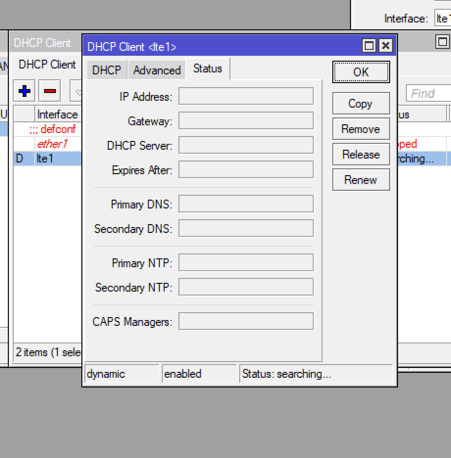

the modem itself is seen and connected, but dhcp does not find … as in the 6th firmware (

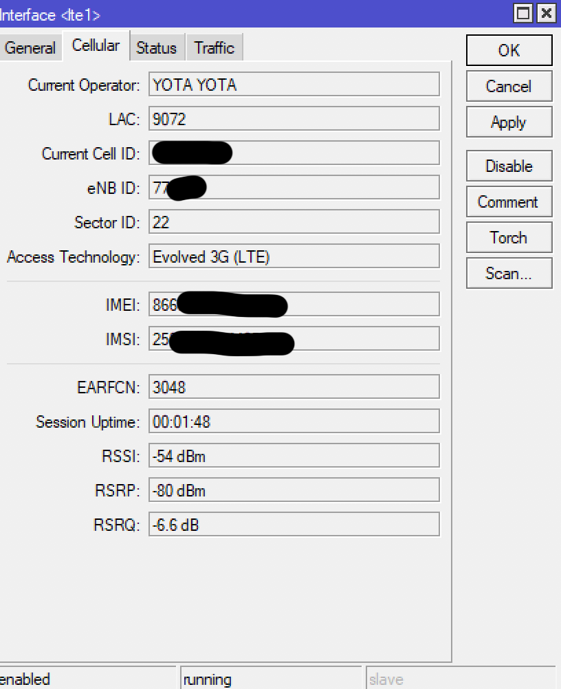

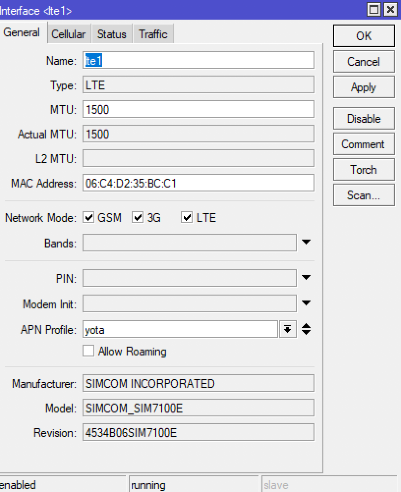

SIMcom SIM7100e modem and mikrotik hAP ac lite
What are the options? why dhcp does not work?
how it looks physically is here

Thanks to the support of Mikrotik. It is necessary to switch the sim7100 modem to the mbim interface.
/ interface lte at-chat lte1 input = “AT + CUSBPIDSWITCH = 9003,1,1”
