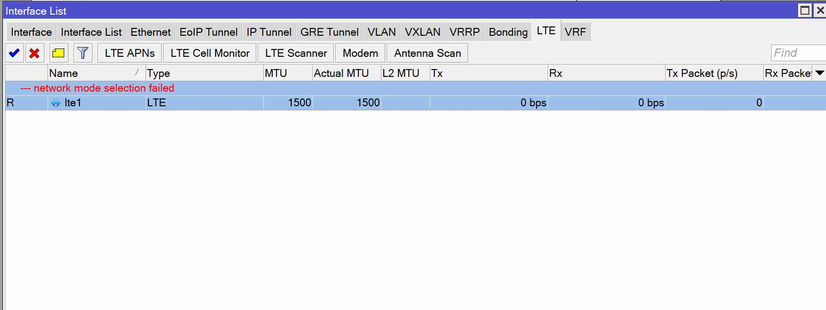

LTE netwrok mode selection faild?
I have 2 LTE modem , and when I enable them I get this error:
“Network mode selection failed”
I have mark only lte \ 3g \ gsm , and also try all option - I still get this error
but the modem is connected to the ISP and working ( I get an IP , ping to google download spped at ~ 50Mbps )
so what is it ?
Thanks ,
What model of the modems you have?
Regards.
Same problem on Chateu LTE12 - no LTE and interfaces list says ’ network mode selection failed’ above the LTE interface.
I’m using LMT simcard. Sometimes LTE works, but mostly not.

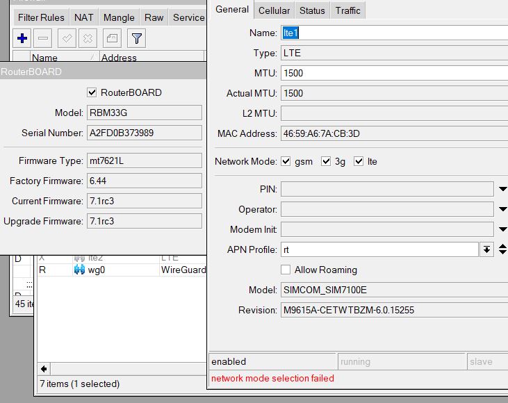

A similar problem. sim7100 modem does not work. error LTE netwrok mode selection faild.
About SIM7100 I not have information, best way will be get a AT Command pdf and put proper mode by at-chat feature.
About Chateau LTE12 the upgrade of firmware can solve that problem, this internet can be provided per LAN port, it’s not must be from lte1 itself.

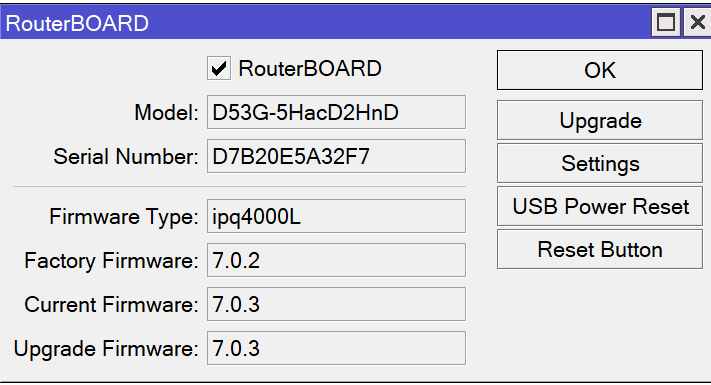

Just bought CHATEAU LTE6 and I am having major issues.
Model is D53G-5HacD2HnD&FG621-EA
Firmware type ipq4000L
Upgraded to firmware 7.10.2
LTE firmware is 16121.1034.00.01.01.03
