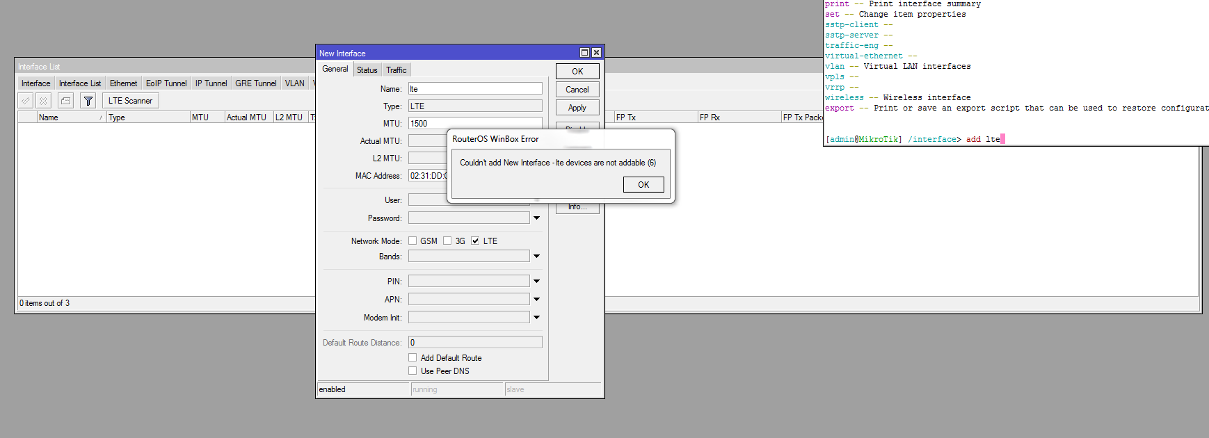

I just bought a NetMetal Ap with LTE support (LTE built-in) but menu interfaces list is not showing any Lte interface! Also if we try to add a new interface a unknown interface error appears ! In Packages there is lte support and also, we have upgraded os to 6.39 (from 6.29 to 6.39) Is there anybody can help me?

Now the situation is : internal modem " /system routerboard usb set type=mini-PCIe " but interface list lte tab not showing any interface and is not possible to add it! I just posted a screenshot about it!
It seems like not recognizing lte hardware…

The RB922UAGS-5HPacD does not come with an LTE modem installed. The SIM in on the system board, but you must install the modem into the Mini PCIe socket.
