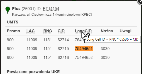

btsearch.pl give me info about this BTS CellID

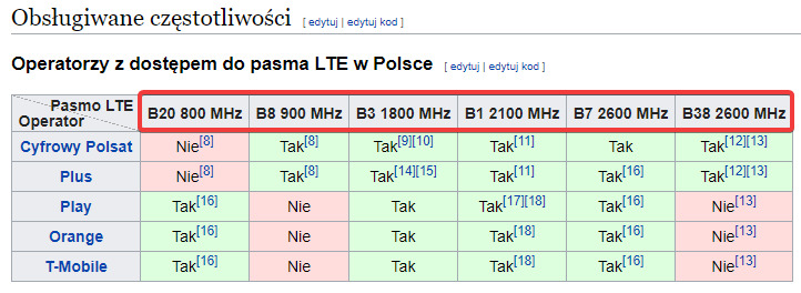

In EMEA we have few Band (frequency) of using 3G/LTE. All tower use the same freq.
Polish Wikipedia give me info
I can select those Band by One and check speed of internet at every of them. One are faster and have worst signal parameters. One are not in range.
After tests I can stay with the fast of ot.
*) About 3G the UMTS works at Band 8 is 900Mhz = UMTS900 and I have signal range only to this.
CellMonitor give me EARFCN = 3030, remember?
This EARFCN “3030” I check at > https://www.cellmapper.net/arfcn?net=UMTS&ARFCN=3030&MCC=0 > and this is Band 8/FDD/946 MHz/5 MHz → slow but big distance
*) Band 1 = 2100Mhz = UMTS2100 - out of my signal range.
