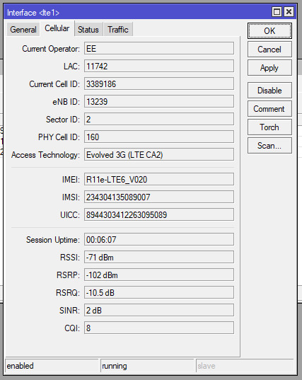

Just bagged myself a LHG kit and been messing around with it at home. Admittedly i have a very poor cellular signal strength due to living out in the countryside in a bottom of a dip but i seem to have the luxury of three different masts.
I have included a screenshot of the LTE readings and was wondering which ones are more important. I have read on another post that RSSI is not a good indicator was was trying to get the best RSRP.
The attached screenshot gives me a speedtest result of around 21Mb down which i thought was a bit poor in all fairness.
Also, is there a way to tell if i have a 2G, 3G or 4G connection ?
Any pointers on which indicators help get the best signal strength and the hence the best speed woudl be appreciated.

Read documentation at wiki: https://wiki.mikrotik.com/wiki/Manual:Interface/LTE
Do upgrade a modem firmware, checking by:
/interface lte firmware-upgrade lte1 upgrade=no ;
At your screen you have LTE. You can select the only 2G or 3G or 4G and watch changes in Cellular tab.
RSRP and CQI are best indicators.
You should upgrade the RouterOS (ROS) version too, you discover new primary-band and ca-band. Use WinBox > System > Package > stable channel and do upgrade.
Remember that modem use only one fast freq aggregation: B3+B7 because B1+B3 or B3+B7 not works here. Other bands like B8 or B20 in aggregation are like fast+slow game.
