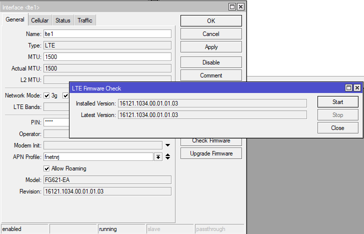

I have the same problem - I have open MikroTik support ticket since 08/Jun/2023 - SUP-118664: “We will notify when new modem firmware will be available with fix.”
No now firmware for LTE card FG621-EA (16121.1034.00.01.01.03) :frowning: There is only workaround to have a scheduler script to diasbale and enable lte interface after reboot :frowning:
