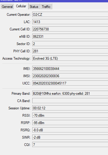

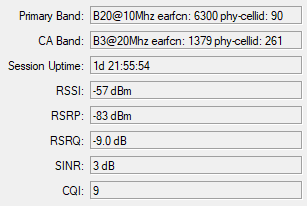

Anyway, outside I had these numbers (pic1) and inside (under roof where it now sits) I have also quite good signal (pic2). Pretty happy…

You can do a speedtest in that 2CA order of force B3 to be the primary-band and do again speedtest.
Sometimes when you revert two bands in 2CA you reach better speed!.
For screenshot it will be:
/interface lte at-chat lte1 input=“2,3,1379,261”
