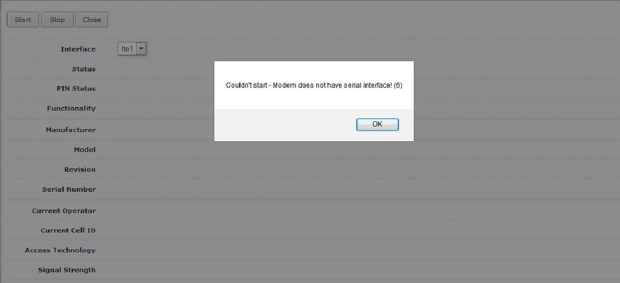

Hello guys,
with a few manual tweaks I managed to get my lte usb stick running
(using the dhcp client for the lte device, removing the sim pin or
feeding the sim pin via the usb stick web interface (sic!)).
All the ip stuff works pretty well from there on.
But there seems to be no way to retrieve any information from the lte device,
that would be normally collected via the usb serial connection (see picture below).
Here’s the corresponding console output:

i suppose the firmware of your ZTE MF823 is uncompatible with the RouterBoard 433GL.
Hello Mobicell,
this is a pitty, since the ZTE MF823 shows up in the mikrotik wiki in the section of supported 4G devices. :confused:
Therefore a little note would be cool so that other users won’t rush into this anymore…
Concerning the driver, do you mean the embedded system on the LTE USB stick oder the driver used by
the RB433GL?
Regards,
bronco
in wiki page there is a note for this modem that some settings are ignored which means that you don’t get full functionality from this modem.
You can still try to load the PPP interface by going into the /port firmware menu and set the ignore-direct-ip-firmware to yes and reboot the router. Then if the modem has correct IDs you should see a USB port which you can use for the ppp-out interface where you could try to read the signal values. Just note that using PPP emulation mode you will not get the max speed as with lte interface emulation.
