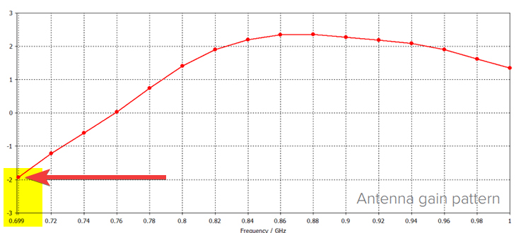

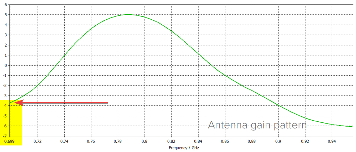

Remember that in RF world not exist any universal antenna on all freq.
Look at graph’s of Gain for LGHR and SXTR - I mark the 700Mhz for you.
LGHR:
SXTR:
As you can see, the gain is on MINUS and for you is not good. On B3/1/7 the sxtr and lhgr have got good Gain but the 700Mhz is missing.

The gain for 700MHz on the SXT an LHG devices are fine with a negative gain (measured relative to an isotropic radiator) - iPhone 11 is around -4.5 dBi and can still get excellent reception/speeds.
