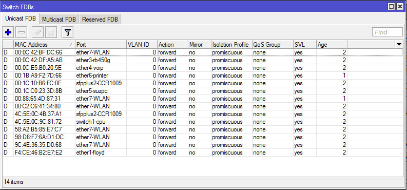

It should “learn” MAC addresses and store it in the switch chips forwarding database (FDB). In winbox I can goto the switch menu, FDBs and see all the learned MAC and what port learned from in the Unicast FDB tab
@rwaters
Nice spotting, that was it :slight_smile:
