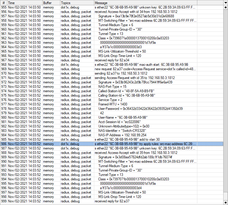

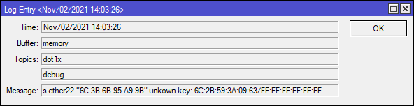

The source mac address that are set from RADIUS server in the Mikrotik-Switching-Filter attribute can not be set dynamically via Dot1x in the Switch rule (CRS328). The log error is shown in the attached image. My attribute value is “src-mac-address 6C:2B:59:3A:09:63/FF:FF:FF:FF:FF:FF action allow, src-mac-address 6C:3B:6B:95:A9:9B/FF:FF:FF:FF:FF:FF action allow, action drop” It does not worl. :frowning: What does it happen? The switch does not support to set the mac address in the switch rule via dot1x, yet ?

You cannot set the src-mac-address (also switch or port), these are automatically populated by the dot1x server as it will have acquired the MAC address of the device attached to the port, see https://wiki.mikrotik.com/wiki/Manual:Interface/Dot1x#Dynamic_switch_rule_configuration
