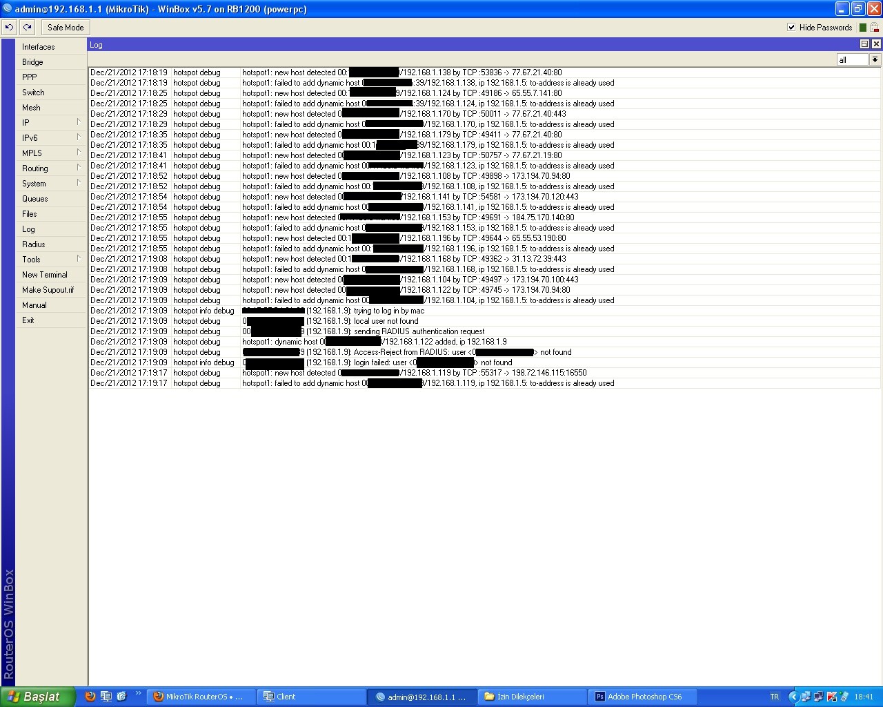

Logs are here
That looks like that mac address is not in the database or the format is incorrect. Looks like it is also checking a RADIUS database with the same result: “User not found”.
